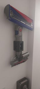

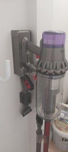

After mounting our Dyson Outsize Total Clean Handstick Vacuum Cleaner on the wall I realised that there was not enough provision made for storing all the accessories.

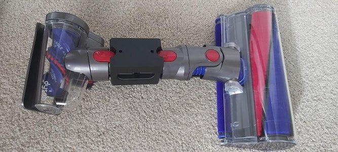

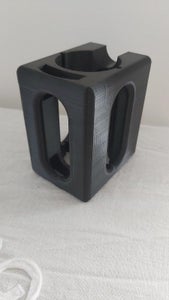

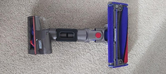

My resulting bracket was designed using FreeCAD and is made to be screwed to the wall. It is able to hold two Dyson accessories. The prints in the photos resulted in a fit that was a little loose with respect to how snugly the clip fitted. I therefore made the oblong cut-out a little shorter. With this done, I needed to print without a brim as the 2nd accessory would then not clip in properly without me first sanding the brim section first (not sure if that makes sense).
Step 1: Final Prints

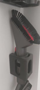

From the photos you will see that one accessory does not fit properly into the holder (not without making a mark on the wall). As these are installed in a cupboard, I am happy for it to just sit loosely in the top hole. For completeness sake however I modified the model, making it deeper. This should allow the part to slide easily into the hole without marking the wall while making it easier for those with fatter fingers to removed the accessories. I also added a 2mm recess on the back to allow for the situation where the wall plugs do not sit 100% flush.
