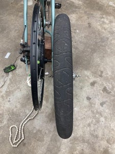

My previous project already is using a 52v 20ah battery so I figured I would get the same size battery again. I figured I could run two batteries in the side car project - since I had no idea how far the finished project would go on a single battery. So I got a 1000w 48v rear hub motor and run it with 52v like my other project.
I would of liked to go with a wider rear tire but the frame spacing didn't allow for it so I was stuck with the skinner 26" rim. I could of went down the rabbit hole and got a wider rim and re-strung the wheel, but as mentioned above, I had a lot of things going on, time-wise and didn't have the time to pursue this.

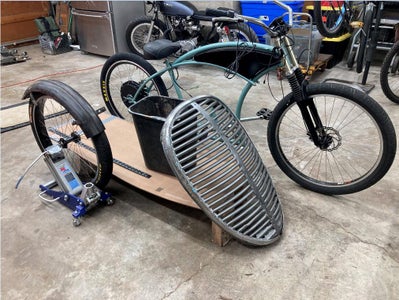

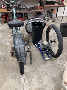

I went through dozens of pictures of motorcycles with side cars on them and as much as I like that old school zeppelin formed aluminum nose for the side car, I also knew that was beyond my skill set and the amount of time I had to put this together.
So I had the cruiser bike, an old 1939 Ford truck grill and a old motorcycle fender laying around and decided to incorporate the grill and fender into the project.
No design really at all, just winging the whole thing. From the pictures I did some mockup and sizing of how big I wanted it all to be.
I took into consideration:
NOT forgetting to be able to turn the front fork left and not run into the side car.
I wanted a space for a cooler in the back.
Having it big enough to fit an adult but not any bigger or heavier than necessary.
The bike only needed to go - maybe - 10mph tops so it didn't need any aerodynamic skinning or anything like that.
Suspension for the 3rd wheel would be nice but it would take longer to build.
I wanted it to be very easy to get into and out of and comfortable enough that you could ride in it for a couple of hours.
The side car has to be easily detachable from the bicycle because we had to break it down and put it in a trailer we were towing to the event where it would be put back together, then disassembled to take back home.

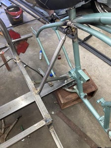

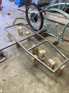

The frame has a very large area behind the seat tube and rear wheel. I figured I would start with a 3"x1" beam bolted to a 3/16" plate I welded to the frame as a foundation for the side car.
From there, I used CAD - cardboard aided design to figure out what the basic frame would look like.
Step 3: Continue Building the Frame and Supports

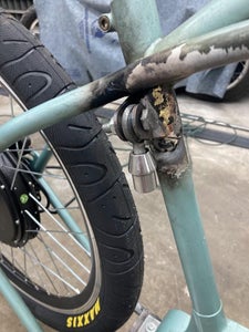

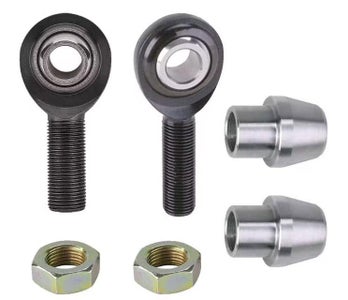

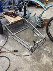

So the flat frame probably wasn't strong enough even with the struts from the bicycle frame to support an adult without bending. So I boxed the frame and started making the struts from the bicycle frame. Since I had to be able to break it down to get it to the event then put it back together, I used some heim joints and tabs from another project. I brazed the tabs onto the bike frame and use the weld bungs that fit into 7/8" tubing for the struts.
Having no idea how strong this needed to be I - despite trying to save weight - added as many struts as I could make fit on the frame.

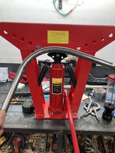

For bending the tubing I purchased a hydraulic pipe bender for the bends. The bends - well I'm not proud of them but I got it done. I need to get a proper tube bender one of these days.

So once the frame was what I thought structurally complete, I started added on the extra bits. The mounts for the grill, how the seat was going to mount, struts for the back of the frame for the cooler.

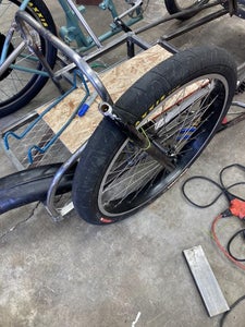

For the axle, I had originally wanted to go with just a single mount for the axle from the frame. The axle is 10mm and I foolishly thought that would work. Well it didn't it bent just when I was working on the frame.
Fortunately I had a old full size cruiser bike fork laying around so I cut it in half and mounted and gusseted it onto the frame (more weight.. I was getting worried).

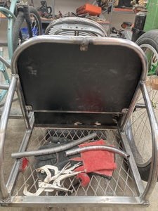

For the floor board I went with expanded metal (metal grate) cut and welded that onto the bottom of the frame. Had to weld it enough so an adult could stand on it and not have it break off.
At this point the initial metal work was done. I could ride the bike around some with a adult in it and it seemed to hold up. An adult could also stand up in the frame and not bend or break the frame off.
