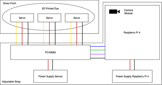

3. Eye Movement Setup
To control the eye movement, I used a Raspberry Pi 4 connected to a camera. I installed OpenCV and used its built-in face detection feature. You can find the code in the attached file faceTracking.py.
⚠️ Important: Don’t skip the calibration step from the original instructions—otherwise, the servos may be damaged.
Since I wanted to animate three eyes, I needed to control nine servos in total. For this, I connected the servos to the Raspberry Pi via a servo driver. Here you can find a video that helped me a lot: Connecting Servo driver PCA9685
  1. The cables for the upper and middle eyes may need extensions to reach the driver.
  2. My servos had JST connectors, so I used cables with JST connectors and added Dupont caps (I couldn’t find a ready-made alternative with short delivery time, but these should also work: ...).
  3. If your servos already use Dupont connectors, you only need an extension if required.
This video by Core Electronics helped me a lot with setting up everything: Face Detection with Raspberry Pi + OpenCV + Python

2. Mounting the Electronics
The remaining components (servo driver with power supply, Raspberry Pi 4 with power supply) need to be fixed securely to the mannequin. To do this, I sewed an adjustable waist belt and attached the parts there. Here is a tutorial that I used to build the adjustable waist belt (unfortunately in german, but I think you can understand it without sound).
a. For the Raspberry Pi, I imported a model by iSikkel from Maker World into Fusion and added a bracket so it could be mounted on the belt.
b. For the servo driver and its power supply, I created custom mounts in Fusion. The servo driver model needed a few manual adjustments, since I had made the connection hole slightly too small. The snap-fits also weren’t very stable, so gaffer tape had to fix this issue :D The power supply, however, fit without issue.
c. Because of its size, I sewed a small fabric bag with eyelets to hold the Raspberry Pi power supply (power bank).
