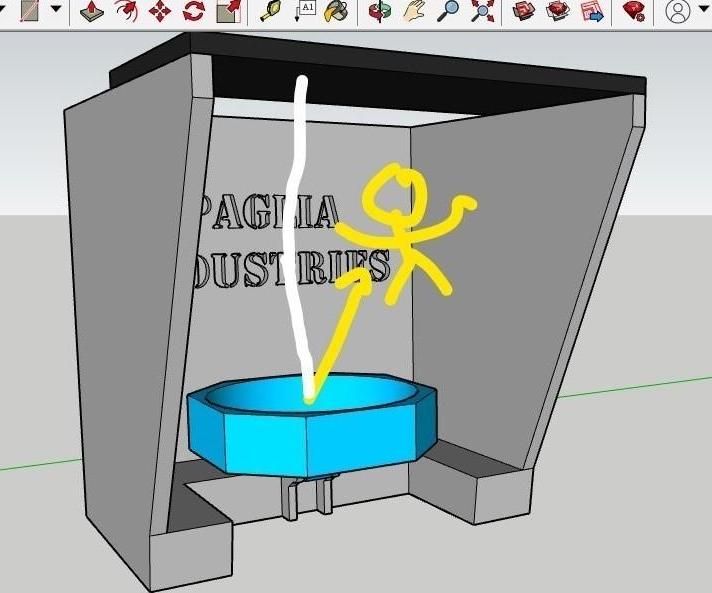

Step 3: Neck Mechanism
Print and assemble.
Neck Bearing Seat (30.4mm H-10mm) gets mounted to the bottom of the head using M3 heat inserts and M3 screws.
When inserting the Bearing seat into the bearing, it should be a tight fit (this will prevent the head from flying off) However, if it's not a tight fit, you should add a small nut/bolt through the bearing seat and neck top to act as a retainer, so the head won't lift/fly off.
For the neck rotation mechanism, I took the rack gear, heated it up to arc it, then attached it to Neck Top. I did this as a "Temporary" mechanism to test; but it's working, so it's going to stay for now.
