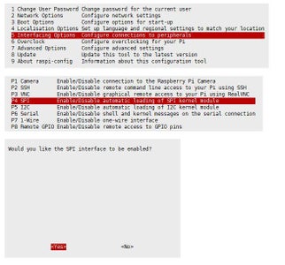

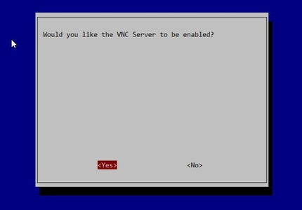

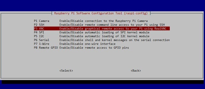

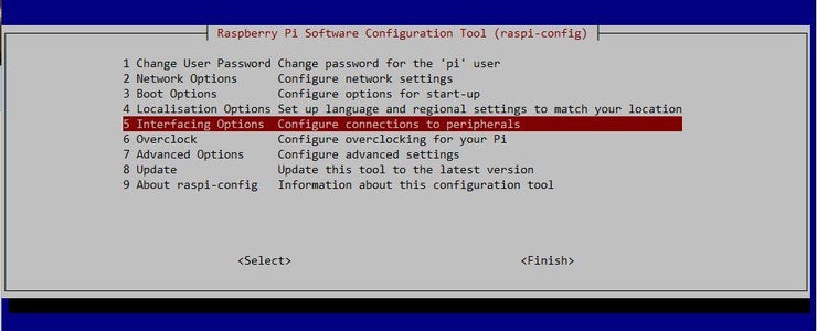

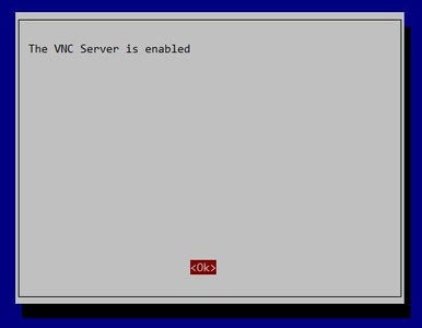

Now, you have to enable VNC to be able to connect remotely and SPI for the e-Paper HAT:
sudo raspi-config
Interfacing Options > VNC > Yes
Interfacing Options > SPI > Yes
And reboot it.

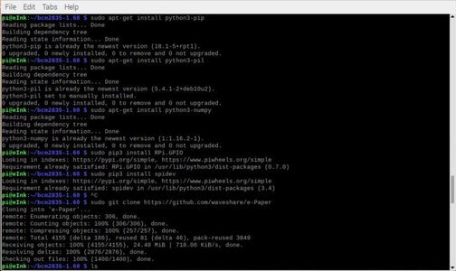

Install Python libraries:
(If you updated the SO with the latest version, all of these steps will be like "Requirement already satisfied").
sudo apt-get update
sudo apt-get install python3-pip
sudo apt-get install python3-pil
sudo apt-get install python3-numpy
sudo pip3 install RPi.GPIO
sudo pip3 install spidev
Now you can download the examples from Waveshare:
(This part is NOT needed, but you can download them to know how it works).
sudo git clone https://github.com/waveshare/e-Paper
cd e-Paper/RaspberryPi\&JetsonNano/

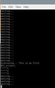

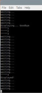

Step 4: Execute the TEST
Go to the correct folder where we have the test file:
cd ~/eInk_Moon_ISS_PeopleSpace/e-Paper/ShowEInk
Execute the test file with the version 3 of Python:
python3 Test001.py
You will have a traced comments meanwhile the program is executed.
And in the e-Paper screen you will see the messages.
For each button, the screen will show a different message.

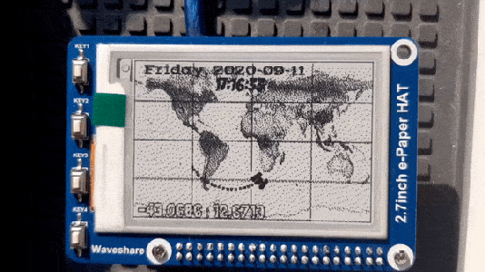

Step 5: Show the Moon / Space / ISS Information....
OK, we have all running and we now want to see where is the ISS over the World, or the phase of the Moon...
First you have to execute the file"ShowInfo.py" (located on "~/eInk_Moon_ISS_PeopleSpace/e-Paper/ShowEInk").
python3 ~/eInk_Moon_ISS_PeopleSpace/e-Paper/ShowEInk/ShowInfo.py
And now, if you press one button, you'll have the information programmed to this button:
● Button 1: Weather forecast.
● Button 2: Who is on the Space and where.
● Button 3: Where is the ISS over the World.
● Button 4: Information of the Moon.
