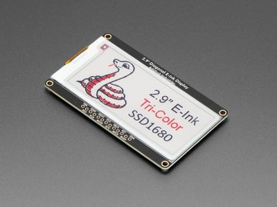

Step 3: EInk Display
eInks are great displays for power saving. I went with a trusted brand, Adafruit, and used their 2.9-inch tri color display. It really only uses current to update the display. The eInk screen then locks the pixels in place showing the image even after cutting power to the display.
Adafruit's great documents for this display (they also talk about other similar screens in this doc).
There are many pins, but we dont need all of them. The PCB routes them correctly. You can use the PCB schematic to see what pins are connected where. The display uses SPI communication.
I ordered two screens, and they’re a bit expensive — around $30 each. I guess I was lucky to get two different versions: one was blue and used the UC8151D chipset, and the other was black with the SSD1680 chipset. Adafruit or a distubuter may give you either one ¯\_(ツ)_/¯. For me, I found that the UC8151D needed a reset (RST) pin, while the SSD1680 did not. So I added a 0-ohm resistor jumper to the trace for the screen’s RST pin. It is needed for the UC8151D but works for both, so it's probably best to just include it.
