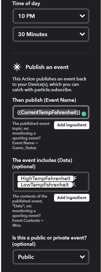

Now click the button to create a new applet. Choose Weather Underground as the service, and select Today's Weather Report as the trigger. Set the time to whenever you want your Particle to receive weather information each day. Select create trigger, then choose Particle for the "then" part of your applet. Select publish an event.
The name of your event should be something unique that no one else is likely to use. If it isn't unique enough, you will get events from other peoples' services. We'll be sending over the temperature information in this applet, so have it include something about temperature. A possibility could be "NewTemperatureInfoUpdate."
In the data field you need to use exactly what is shown in the above photo. This is, not including the quotes, "{{HighTempFahrenheit}},{{LowTempFahrenheit}}". If it is not exactly like this then your particle won't be able to process the incoming data. Lastly, change the event type to public, and create the applet.
This is only half of what needs to be done. You also need to create the applet that passes the condition information. The Weather Underground part is exactly the same. Create a new applet, and setup the Weather Underground service section in the same way. Choose Particle again for the "that" section, and select publish an event. It's the same deal for the name of your event. Make it unique, and something that has to do with condition. A possibility could be "GotNewConditionInformation"
In the data field of your event you need to have exactly the following (without quotes): "{{TodaysCondition}}". Press create, and you should be all set with IFTTT.
