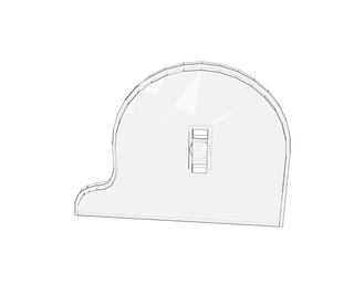

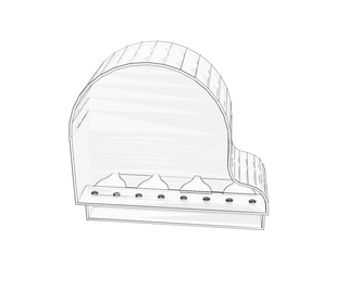

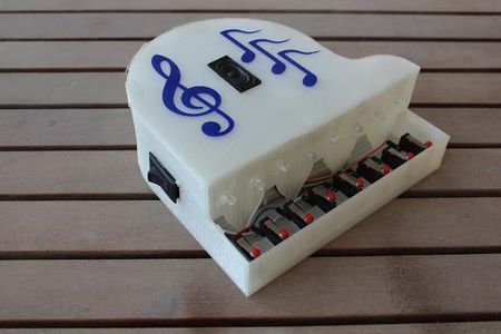

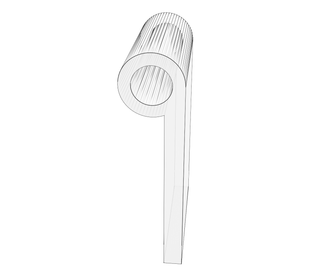

Step 4: 3D Design
You can come up with your own design, but you can use our design from Fablab Dhahran if you have a 3D printer or if you visit any nearby fablabs. The ".stl" file is attached, after you print the Piano you can mount your circuit inside the box and let the buttons appear from the front side of it.
The stl files are divided into 3 prints, Piano.stl has the base of the E-Piano, Piano_Lid.stl has the top cover of the E-Piano, and Piano_Keys.stl has the button covers (if you use limit switches this would be a perfect choice)
The top part of the E-Piano is engraved to allow the speaker we used to be mounted on top as well. If your speaker has a different shape, modify the ".stl" file before printing it.
Enjoy the nostalgic melodies with your E-Piano :D
