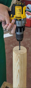

Step 13:
Then, I drilled a hole exactly in the middle of both ends to a size that my ¼ inch axle will fit into. It is best to make the hole too small to start with then make it bigger to ensure the hole isn't too wide and the axle doesn't slip out. I wore safety goggles and made sure it was tightly clamped at a 90 degree angle. Clamp it in a wood vice not a metal vice to avoid damaging the wood.
Step 14:

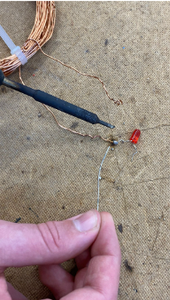

Step 15:
Then, I tightly wrapped my 10m copper coil around the wood for a circular shape, minimizing overlap as much as possible. I then slid it off the side of the wood and zip tied the coil together for a ring shape. On either end of the coil I then soldered the correct poles of a red LED light whilst wearing safety goggles and keeping my hands away from the heat.

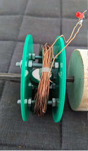

Step 16:

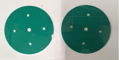

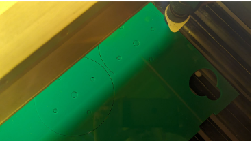

I then designed 2 holders for the copper coil of the generator using V3 design. The hole for the axle was circular so that it can spin freely without the coil rotating. I then put 4 holes around the center to fit M6 screws. I exported it as a .DXF file onto a USB stick. To check my design worked without wasting expensive materials, I laser cut my design on to card. I discovered that the 4 holes were too close to the center for the coil to sit on them so adapted the design, did 1 test run and then laser cut it onto green 3mm acrylic. I placed a neodymium magnet eithers side of the axle. Then, I used M6 screws and nuts to secure the holders either side of the 2 magnets and places the ring of copper coil over the screws where it sits.
Step 17:

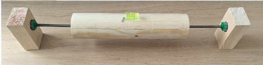

Step 20:

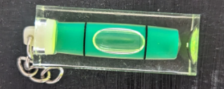

At this point I slotted in the axle and speedbump to test out the angle. I discovered that the axles were bending down a little bit under the weight so I used a hammer to knock both axles further in and after that it was much more secure. I used a small spirit level to check if the axles were straight and the speed bump was perfectly straight.
Step 21:

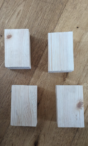

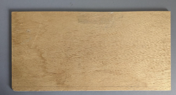

Finally, I built a model road to be as accurate to a full model as possible. I cut 2 thin 400x200mm rectangles of plywood using a hacksaw. The plywood was old and slightly damaged on the sides but since it is of a road (which are usually in bad condition anyway) it worked well.
Step 22:

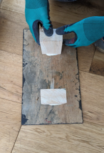

I cut 4 planks of wood to 130x70x45mm. I then used the belt sander in order to make a smooth surface. However, I was not satisfied by the height of the speed bump above the road so I further sanded the wood planks equally so that the road was lower. The speed bump is now around 1 or 2 cm raised above the road which I believe is a good balance between effectiveness and safety.
Step 23:
Next I used wood glue to glue 2 of these planks to the bottom of each piece of plywood to act as a stand for the road. The planks were roughly centred and the same distance from opposite ends resulting in a stable and straight road surface.
In order to confirm that the roads were straight I once more used the spirit level and once more it was shown to be almost perfect.

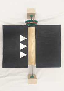

Finally, I assembled the pieces together and the build was complete.

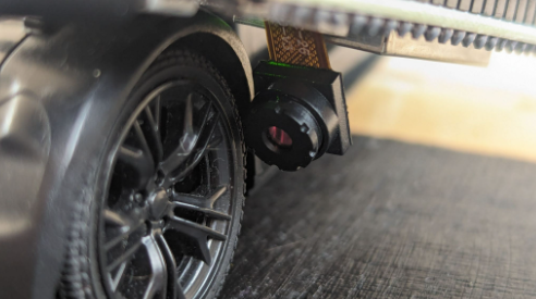

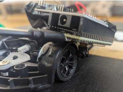

Step 27: Testing
In my user testing, I begun by testing it with a remote control car. In testing we discovered that the height of the speed bump from the road was perfect, as the front of the R.C car ramped up it without being damaged but clearly would have to slow down as a precaution. As shown in the images, I attached a camera to the R.C car which shows an angle of the wheel hitting the speed bump and traversing across it, as shown in the videos. I achieved this by using my ESP32 camera module in which code on the Arduino IDE app connects the ESP32 to your Wi-Fi and creates an IP address containing the software to view the camera and customize the image (apologies for the bad video quality it was the best I could do). The videos clearly show the front wheels hit the speed bump and continue over it. However, due to the fact that the weight of the R.C car is not proportional to that of a real car, there was not enough force to rotate the speed bump on it’s axle. However, in another type of testing, the R.C cars wheels rotate the speed bumps which proves the potential is there. The 2 bearings and their wooden stands also performed well under weight, with close to zero bending. The project is a very good setup for the future of this innovative idea, but there are improvements to be made...

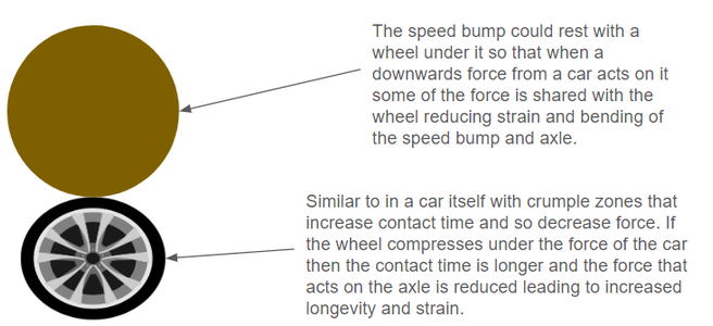

Step 28: Future Modifications
The two updated fusion 360 designs attached show a steel speedbump as opposed to the wooden one (better durability, withstanding weather etc.) and the generator being incased for safety. On the other hand, the road markings are a good start but since there are significant changes to almost every aspect of the design and this means that in order to properly inform drivers of the new design, unique and special road markings should be implemented as the interaction between cars and the surface are very different in my product than with the original. There are a large number of extra changes that could be made to perfect the design (such as adding a rubber shell for grip) and I look forward to addressing issues to improve my model.
