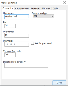

Setup Notepad++
Install Notepad++ on your PC: https://notepad-plus-plus.org/downloads/. Open Notepad++ and go to Plugins > Plugins admin and search and install NppFTP. After installation go to Plugins > NppFTP > Show NppFTP window. To connect to the FTP-server of your Pi:
Right click in the NppFTP window > Create new profile
Hostname: raspberrypi
Username: pi
Password: [your password of the Pi]
Click Close and give your profile a name. Right click on it and connect!
All set for the real work!
