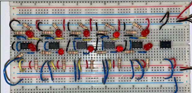

The schematic in Figure 7 was then breadboarded. Here are the steps required to build the circuit:
  1. Place each op-amp on the board. Only 5 MCP6002s are needed because there are two op-amps in each chip.
  2. Pin 1 to cathode of LEDx
  3. Pin 2 to LEDx_threshold_voltage_output (from voltage divider, where x is the current LED circuit that is being built)
  4. Pin 3 to output (Pin 6) from AD623 (see Step 2)
  5. Pin 4 to GND
  6. Pin 5 to output from AD623 (used a rail for easy access that was not being used for power or GND)
  7. Pin 6 to LEDx+1_threshold_voltage_output (from voltage divider, where x is the current LED circuit that is being built)
  8. Pin 7 to cathode of LEDx+1
  9. Pin 8 to 5V
  10. Place the AD623 on the board.
  11. Pin 1 to Pin 8 with 33Ω resistor
  12. A resistor of 33Ω allowed the output voltage of the in-amp to be about 3V with 50 Jenga blocks. The load cell’s zero point was not actually zero, so we had to add a bias voltage (2V) to the in-amp to force its zero point to be zero.
  13. Pin 2 to load cell output (white)
  14. Pin 3 to load cell output (teal)
  15. Pin 4 to GND
  16. Pin 5 to 2V bias voltage
  17. Pin 6 to positive terminal of op-amps (Pins 3 and 5 on each MCP6002)
  18. Pin 7 to 5V
  19. Pin 8 to Pin 1 with 33Ω resistor
  20. Add each op-amp’s voltage divider
  21. Pin 3 (and Pin 6, but separate voltage divider) on each op-amp was connected to the node between the voltage divider resistors.
  22. 5V voltage source → variable resistor → (Pin 3/6) → 1kΩ → GND
Once all steps have been completed, the circuit should look like Figure 8, with yellow wires as placeholders for each of the variable resistors from the voltage dividers:
Figure 8. Breadboarded circuit, with placeholder wires (yellow).
