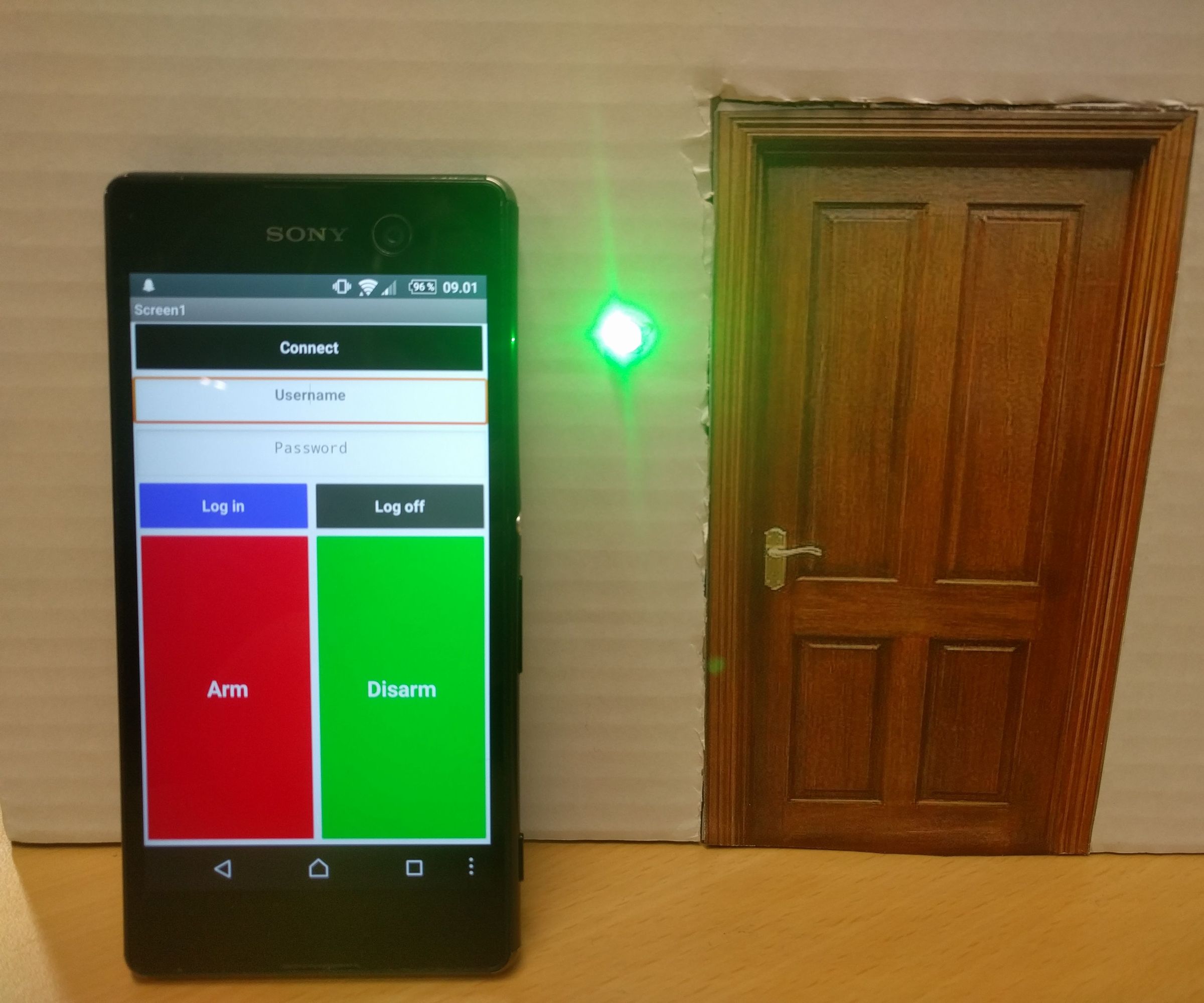

In this Instructable we will show how to make a door security system. The idea is to use a Hall magnetic sensor to detect whether a door is open or closed. The Arduino program is then setting the colour of an RGB LED. If the door is closed the LED is green, if the door is open the LED is blue and if the door has been opened for too long the LED is red (indicating a security risk).
Furthermore we will show how to use an Android application, to log on to the security system, by sending a password over bluetooth and either arm or disarm the security system. When the security system is armed opening the door will result in an alarm going off, in form of the LED blinking red.

Step 6: Android Application
The Android application is developed using MIT's App Inventor 2, which is a free Android application builder found at http://ai2.appinventor.mit.edu/.
To connect to the Bluetooth module via the app there had to be made a list picker with a Bluetooth client in it. In the list picker we programmed Bluetooth client addresses and names, so you can choose the Bluetooth module you want to connect to.
The log in button sends the text that has been entered in the password textbox to the Bluetooth module. The log off button sends byte number 50 to the Bluetooth module which is read as the integer 2 in the Arduino program.
The arm and disarm buttons can only be activated when the correct code is entered, and you are logged in. Each button sends a byte number to the Bluetooth module, arm sends byte number 49, which is read as the integer 1 in the Arduino program, and disarm sends 48, which is read as the integer 0 in the Arduino program.
The application and MIT APP Inventor 2 project can be downloaded below.
