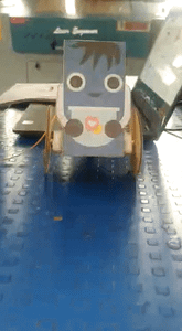

Step 4: Cut Again and Do Some Wiring
Cut it out again and now you have thick cuts of the given design. Follow the marking to place copper or conductive tape and connect 3 ribbon wires of 1m each from remote to the body using a soldering iron. Stick front face to its place as shown in the image.
Step 5: Glue Motor and Battery
Fold design from given marking and glue motor using silicon hot glue. Solder motor wires on it given place. If the motor runs backward then change the wire orientation and resolder it again. Glue or tape battery in its place.
Step 6: Glue Wheels
Glue both wheels on motors and Here you have done!.
Step 7: Test
Next and Final test run it to see it working well or not.
