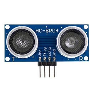

  • Ultrasonic Sensor HC-SR04

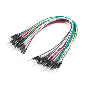

  • Jumper wires

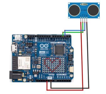

Step 2: The Circuit
  • Connect Ultrasonic module pin (VCC) to Arduino pin [+5V]
  • Connect Ultrasonic module pin (GND) to Arduino pin [GND]
  • Connect Ultrasonic module pin (ECHO) to Arduino pin digital (2)
  • Connect Ultrasonic module pin (TRIG) to Arduino pin digital (3)

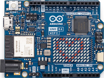

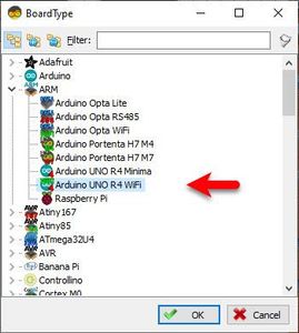

Step 3: Start Visuino, and Select the Arduino UNO R4 WiFi Board Type

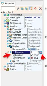

Start Visuino as shown in the first picture Click on the "Tools" button on the Arduino component (Picture 1) in Visuino When the dialog appears, select "Arduino UNO R4 WiFi" as shown on Picture 2

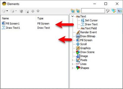

  • Select ArduinoUNO R4 WiFi board and in the properties window expand Modules>Display and select Elements and click on the 3 dots button, in the Elements window drag "Fill Screen" to the left side and drag "Draw Text" to the left side and in the properties window select "Text" and click on the pin icon and select "String SinkPin"
  • Close the Elements window
