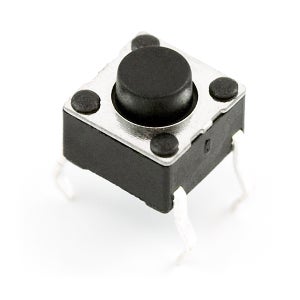

3) Switch (recommended) the potentiometer I used had one built in, and small push button switches are really cheap and make the project quite a bit safer especially if you are using a regular potentiometer. If you loose control, your motor's stalling, something's smoking, a press of the button will put the speed controller in neutral mode. 20 for $1.50 http://www.ebay.com/itm/10x-B10K-Ohm-Linear-Taper... you can also use a toggle type switch, but my code is meant for a pushbutton one as that is what I had on hand

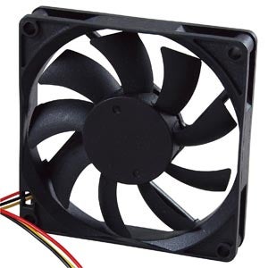

3) computer fan- cheap and safe to test on before controlling more powerful motors(recommended)

To wire the switch, wire one pin (choose either one) to ground, and the other to digital pin 2. . To protect the input pin you can add a resistor between the switch and pin. Also, don't forget to either set the pullup resistor internally or wire one manually.My code has one set up internally. I know it's intuitive to simply add a switch between an input pin and ground, but apparently this will be a "floating pin," which can turn on and off by itself.

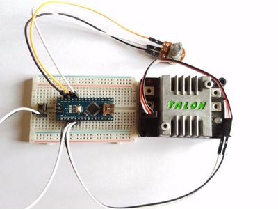

Here is a wiring diagram I drew for myself as well as a picture of all the components connected via a breadboard and jumper cables. I hope these help you connect/check your circuit.
Note: To keep it neat I used two of the ground pins, one for the potentiometer and the other for the switch and talon. All the grounds are the same, so wire them however you please. In my final version, I wired them all to one pin,
If you decide to use different pins make sure to change the code accordingly.

Switch 1st pin :Gnd
Switch 2nd pin: Digital pin 2 or choose any digital pin(purple box) no need for PWM

Once you have uploaded the code to your arduino, plug all the components in, and then plug the usb cable into the arduino to provide power.
If you used a switch, once you press it, you should be able to rotate your potentiometer back and forth and get some reaction from you speed controller
For your own sake, please don't start off by controlling a powerful motor. Start with something small such as a computer fan(if your controller is meant for dc motors) or even a voltmeter to test with. Once you are confident in the hardware and code, control/test your motors to your hearts desire.
