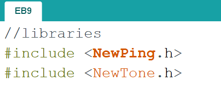

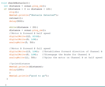

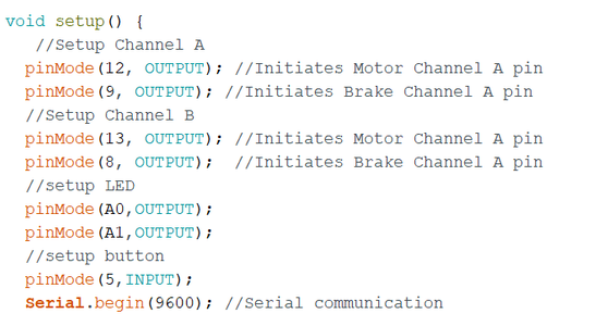

Step 8: Programming
--> You'll need the Arduino IDE. This link takes you to the Arduino website where you can download it. I recommend the zip file for non-admin install.
--> This sketch uses a few libraries (NewPing/NewTone). I've included pictures and links to explain how to install them, and how to use them.
--> This sketch is a work in progress. I'm a self-taught programmer, so if there are more effective or efficient ways to achieve the same functionality, I'd love to hear about them.
--> Download the Experibot.INO file to get a copy of the code.
