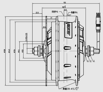

At the time, the internals of an ebike motor were a mystery to me, and not one I was particularly interested in exploring. The bike wasn't under warranty and I figured the motor was shot, so I tried to find a replacement. Between the original US manufacturer of the Infinity and the Canadian vendor who sold it to me there turned out to be a single replacement motor in stock, a 500w version, but one that should fit into the hub, thus saving me the cost of having someone build a bike wheel around it. Fortunately (as it would turn out) that one motor went to someone else, who discovered that due to a small change in its design it did not in fact fit into his hub and thus wouldn't have fit mine either. He ended up buying a whole new wheel with the motor built in. I tried to as well, but mysterious shipping issues arose and I never did get my motor. That cost me months but not money.
If I wasn't able to replace the motor I had no choice but to repair it. I'd already pulled the motor from its wheel housing but there wasn't anything visibly wrong with it. Perhaps a component I couldn't see had failed? The only obvious candidate was the clutch, a metal disc with, I assumed, complicated bits inside, and the sort of thing you hear about slipping. Replacements were cheap and easily obtainable online so I ordered one, plus the gear puller I'd need to get the old clutch off. These items having arrived, I pulled the clutch and in the process discovered that the pin that holds the clutch and planetary gears in place relative to the axle was in two pieces (light and dark, pressed together, as shown here).
