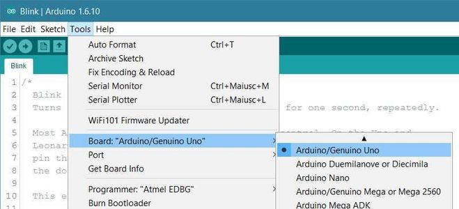

Step 10: Download Pre-made Library for the Microcontroller
The pre-made program included has all of the proper pins set up already for the microcontroller so long as the breadboard is wired correctly. In the Arduino IDE, make sure to select the Arduino UNO under the Tools tab and set the port to the COM port listed while the micro is plugged into a computer. Open the program in the files section then hit the small right-facing arrow at the top of the IDE to upload the program to the microcontroller. With the lighting cable plugged into the proper output pins, the lights should activate.
