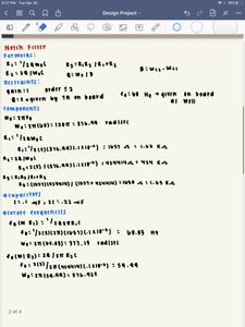

Step 2: Step 2. Calculate Your Components
In this step you need to take your knowledge about an ECG and the restraints to calculate the values for the components of the circuits. For input voltages it is typical to use 9V, so do calculations based off of a 9V battery or power supply.
Here are examples of how to do the math for the components of the ECG.

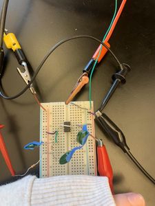

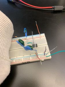

Step 4: Step 4. Build the Components on a Breadboard
Use the schematics you built on LTSpice and build the components individually. Put them close to each other, because for the combined circuit later they will be in series.

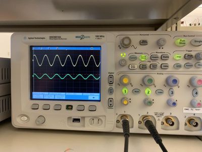

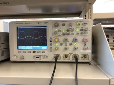

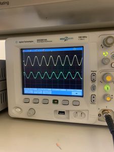

Step 5: Step 5. Test the Components
Once again test each individual component and make sure they are all working before combing them together. This can be done with a function generator, power supply, and an oscilliscope. Here are what the outputs should look like displayed on the screen

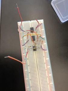

Step 6: Step 6. Combine the Components
To combine the components use the output of the INA to be the input of the notch filter and the output of the notch filter to be the input of the low pass filter. The input will go into the INA and the output will come from the low pass filter.

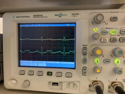

Step 7: Step 7. Run a Human Signal Through
This can be done with ECG leads, and the leads will go on your ankles and right wrist in Configuration 2. If you do not have access to these leads, a simulation of a cardiac wave from a function generator will also work.
