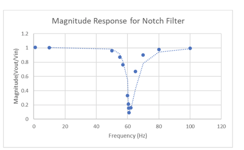

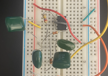

Step 2: Build the Notch Filter
Build a notch filter in LTSpice using the above LTSpice schematic that is given. This can be verified by running the program and plotting the voltage of the output node. This should result in a cutoff frequency of about 60Hz. Once the numbers and circuit are verified on LTSpice, begin building it on the breadboard below the INA. Using the same columns from earlier, connect pin 4 on the op amp to the negative power supply and connect pin 7 to the positive supply.
Using the function generator and oscilloscope, test the output from pin 7 of the op amp. When the frequency is set to 60 Hz, the magnitude of the voltage should drop to 0 or very close to 0.

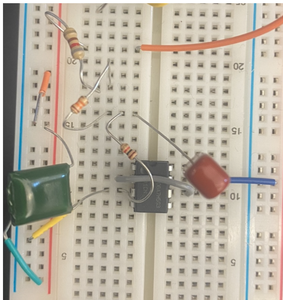

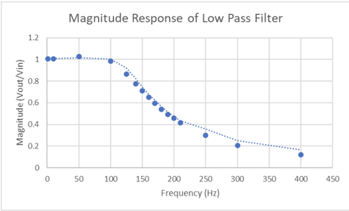

Step 3: Build the Low-Pass Filter
Build a low-pass filter in LTSpice using the above schematic. This can be verified by running the program and plotting the voltage of the output node. This should result in a cutoff frequency of about 150Hz. Once this is confirmed, begin building the circuit on the breadboard below the notch filter. Using the same columns from earlier, connect pin 4 on the op amp to the negative power supply and connect pin 7 to the positive supply.
Using the function generator and oscilloscope, test the output from pin 7 of the op amp. The magnitude should begin decreasing as frequency in increased and should reach about 0.7*Max value when the frequency is set to 150Hz.
