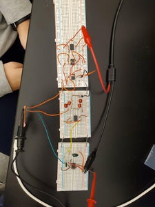

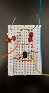

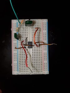

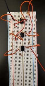

Step 3: Build Your Circuits
In this step, you are actually building your circuit components. It is recommended that you test each filter/amplifier separately to ensure that it is working properly. To test your circuits, hook up a function generator to your circuit and oscilloscope as well as the output voltage to the oscilloscope. This will allow you to compare your output signal to the input to ensure it is working. To test your notch filter and low pass filter, you will have to vary the frequency of your function generator and record the resulting magnitudes of both input and output signals and the phase shifts.

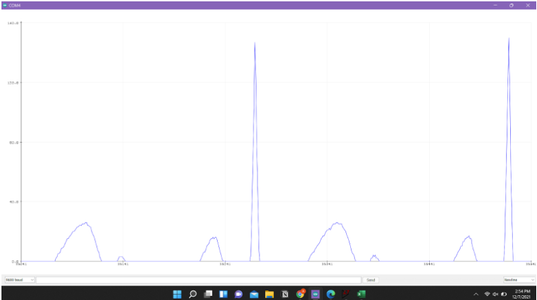

Step 5: Connect and Test Your Total ECG
Now you can connect all of your filters together and test the ECG! For this, you should also set the function generator to a cardiac signal. Compare the results from the oscilloscope to what you should expect and act accordingly.
To test the ECG on yourself, disconnect the function generator and the op-amp power supply. Connect the op-amp power supply to a 9 V battery and ECG leads/electrodes to yourself and the circuit. Then continue to observe your results.

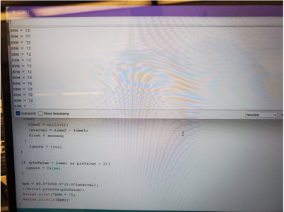

Step 6: Arduino BPM Calculator and Signal Graph
Congratulations, you have finished building the ECG filter component! Now you can start coding for Arduino. With the Arduino, you will need to graph the signal and also code for a BPM calculator. To start with this, you will need Arduino downloaded on your laptop. When opening a script, make sure that you are connected to the correct COM port with your Arduino. After that, you can start your coding!
If you want to do extra, you can attach a LED to the digital output and code according to see the QRS complex of the ECG.
