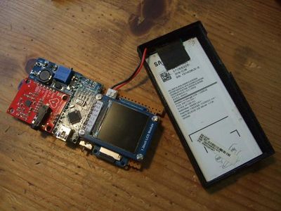

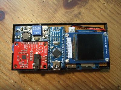

  1. Arduino Nano
  2. AD8232 EKG Sensor Module
  3. 1.3 inch LCD-Module 240x240 ST7789
  4. microSD-Card Module
  5. Step-up Regulator 5V (or adjustable)
  6. LiPo Battery (from Smartphone)
  7. two Switches
  8. Perfboard

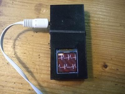

I'm not good at programming so I was very glad to find the great project of Peter Balch linked above that I could use as a basis for my ECG.
What I wanted is to see the ECG-trace on the display and to store it on an SD-card like a holter-ecg. Unfortunately with an Arduino nano it is not possible to do both at a time, so you have to switch between the two functions. Which is not too bad because otherwise it would be very energy-consuming writing the ECG for many hours to the SD-card with the display always on.

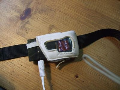

Moving the arms may produce a lot of artifacts, so be sure to find a good place for the electrodes. I also fixed a plug with a line to the AD8232 as the forces on the built-in plug seemed quite high when wearing the device with a belt around the waist.
Unfortunately I don't have a circuit diagram, but connecting the devices should not be too difficult reading the code. I have one switch for on/off and one for display/SD-card. As only switching from SD-card to display will close the file on the SD-card correctly it is advised to do that before switching the ECG off. And for the same reason take care the battery doesn't run out.
Most part of the code for creating the ECG plot is from Peter Balch, only that my another display-controller is different from his. I adapted the size of the curve, removed, among other, the 50Hz filters, the Poincaré plot and the fast ADC (I saw no improvement from the latter). Everything concerning the SD-card is from me and might be improvable. It is still work in (slow) progress, please don't mind the mix of English and German. Switching to SD-card will always produce a new file (with a counter).
Because of the speed of the Arduino a new value is written to file every 5 ms approximately. But this depends highly on the speed of the SD-card! I tried to improve it, without success. But the quality of the resulting figure is good enough. In the file there are two rows, one with the millis and the other with the value for the amplitude from the AD8232. Depending on the further processing a comma or space is needed as separator.
