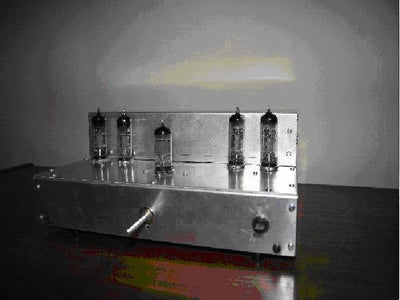

The valves used are ECL80s these have the advantage of consuming only 300mA at 6.3V for the heaters and are readily available very cheaply on e-bay. The disadvantage is the low power handling capability and the common cathode of the pentode and triode sections of the valve. These valves were commonly used as frame oscillator and output in 405 line TV sets and also as single ended audio output and amplifier in some TV and radio sets.

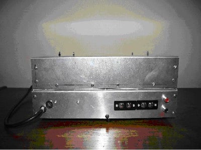

The chassis was fabricated from 1.2mm aluminium sheet this is also available from RS, Part Number 434-043 for 5 sheets 300 x 200 x 1.2mm. The chassis measures 300 x 200 x 30 mm plus the transformer cover.

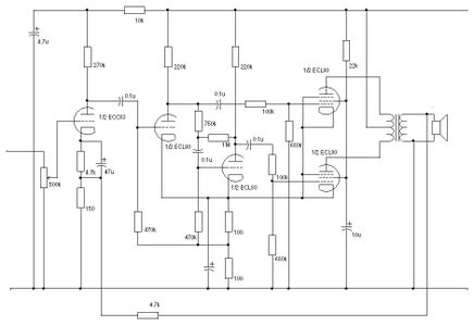

The schematic diagram of the amplifier is shown below. It was found necessary to add the grid stopper resistors to the pentodes to prevent instability.
If more gain is required a single ECC83 double triode can easily be added. This valve gives one triode for each channel.

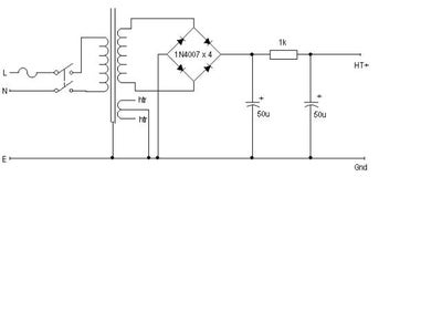

The power supply for a the stereo version needs to supply 6.3V at 1.8A and 200V at approx 100mA including the optional ECC83 stage. This makes the sourcing of a suitable transformer fairly easy. A suitable power supply schematic is shown below.

When driving a pair of Wharfedale Denton loudspeakers the sound quality is very pleasing and the volume is ample for a large room. I have been using the amplifier without the 4.7k negative feedback resistor, but if added should reduce distortion and increase frequency response. Note: When I added the 4.7k resistor to provide global negative feedback the amplifier became unstable at supersonic frequencies. When I looked at the phase shift in the amplifier the output phase shifted as the frequency was increased, this may be caused by the output transformers. One solution to this problem would be to provide some inductance in the feedback loop. The amplifier is now being used without this feedback.
