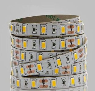

Step 3: Placing the LEDs Strips
Place the frame on a table or a desk, wall face up.
Start by soldering 2 wires, 5cm each, one black on the - pin and one red on the + pin at the start of the LEDs strip#1.
Then peel 5 or 10 cm of the protective layer and start to place the strip, slowly progressing to fill the whole circle.
When it's done, cut the strip#1 (only at the mark). It will normally overlap a little bit.
Solder 2 wires, same as before, to the start of strip#2.
Then do the same process as for strip#1 to glue the strip#2 around the frame. It will normally overlap a little bit.
Now you have to solder the 2 wires at the start of the strip#2 to the end of the strip#1. Black on - and Red on +.
