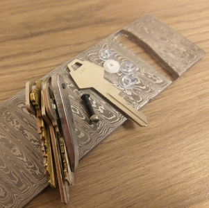

This was my first time machining Damascus steel, so I kept the design of the KEY-tool part as simple as possible.
Lots of features can be added to the tool later, for now a minimal Pry-bar with a 2.5mm hole for tapping to M3 was all that was need to prove the concept.

Once the design was finalized I used white Delrin for the KEYcore parts.
I hand tapped the M3 threads in the Damascus Pry-bar and rounded the tip to create the pry bar on a 3m grinding wheel.

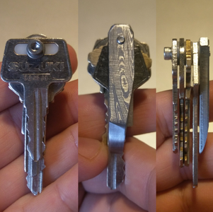

Each key gets a Delrin core, and then one M3x16 bolt with a washer is threaded through into the Steel.
The Finished assembly has a nice weight from the steel, and the keys rotate smoothly.
No jangling, no noise at all actually and the compact form is easily tucked into even the smallest of pockets.
