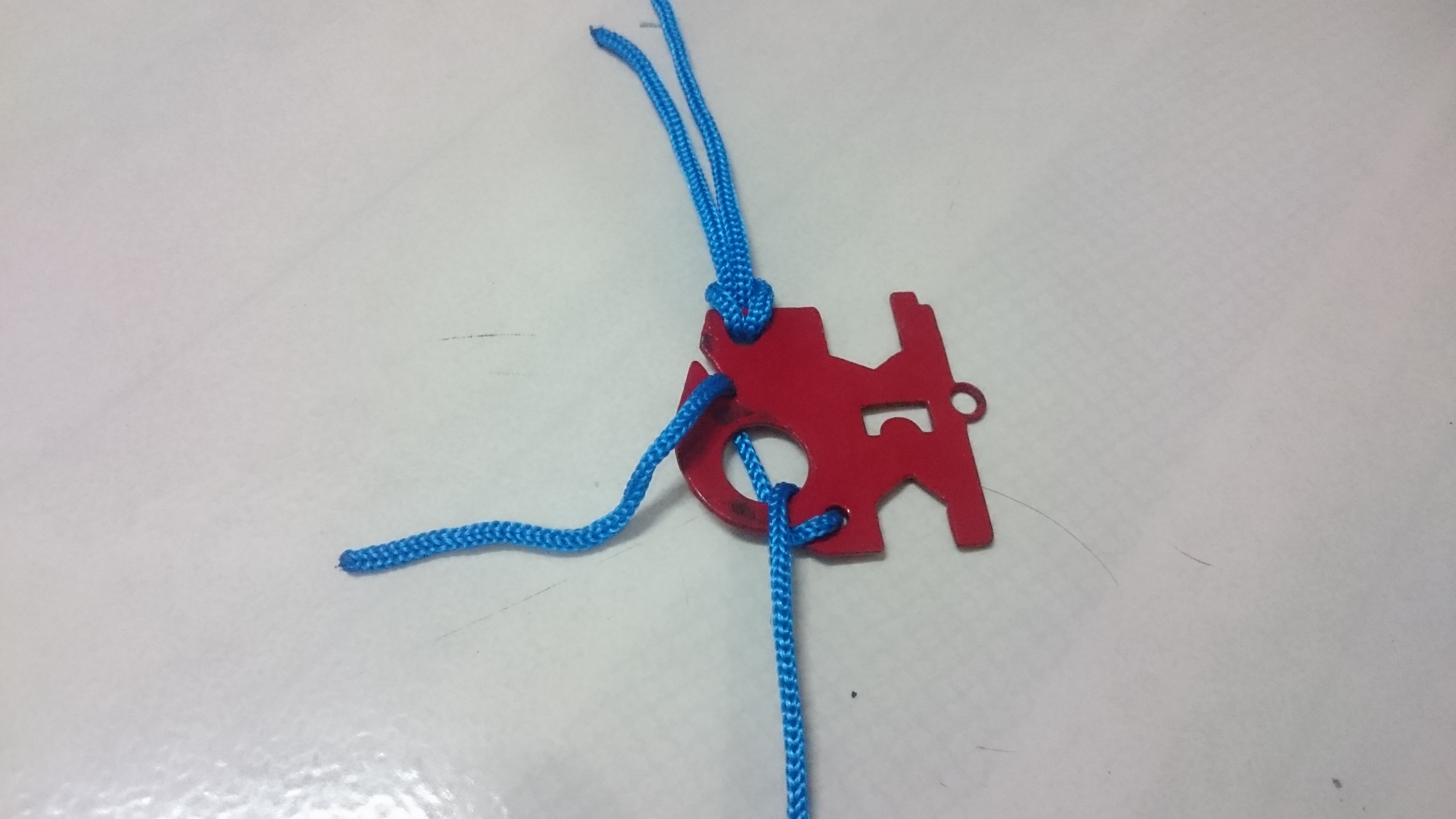

Step 5: Pendant
Get your paracord through the top hole. Make a single hitch in the middle, so now your cord is parallel to your pendant (oh, I am not good in knot terminology but I hope you can understand from the photos above). Now make running loops for both ends of the cord. This photos are just sample so that they are easier to follow. You should make the ends as short as possible.
Now we get an adjustable bracelet with survival pendant :) The paracord I used is 5 feet and that can be used for any other purpose when we go outdoor.

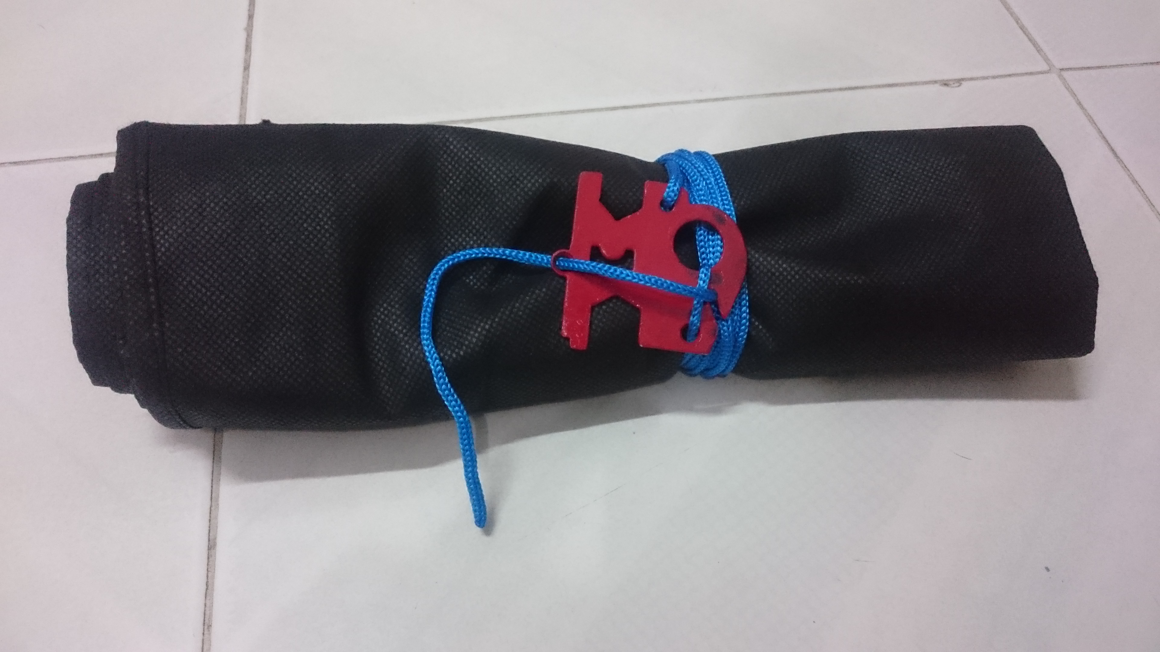

Beside having it as a pendant or a keychain, you can simply keep it in your wallet. It is smaller than a credit card.

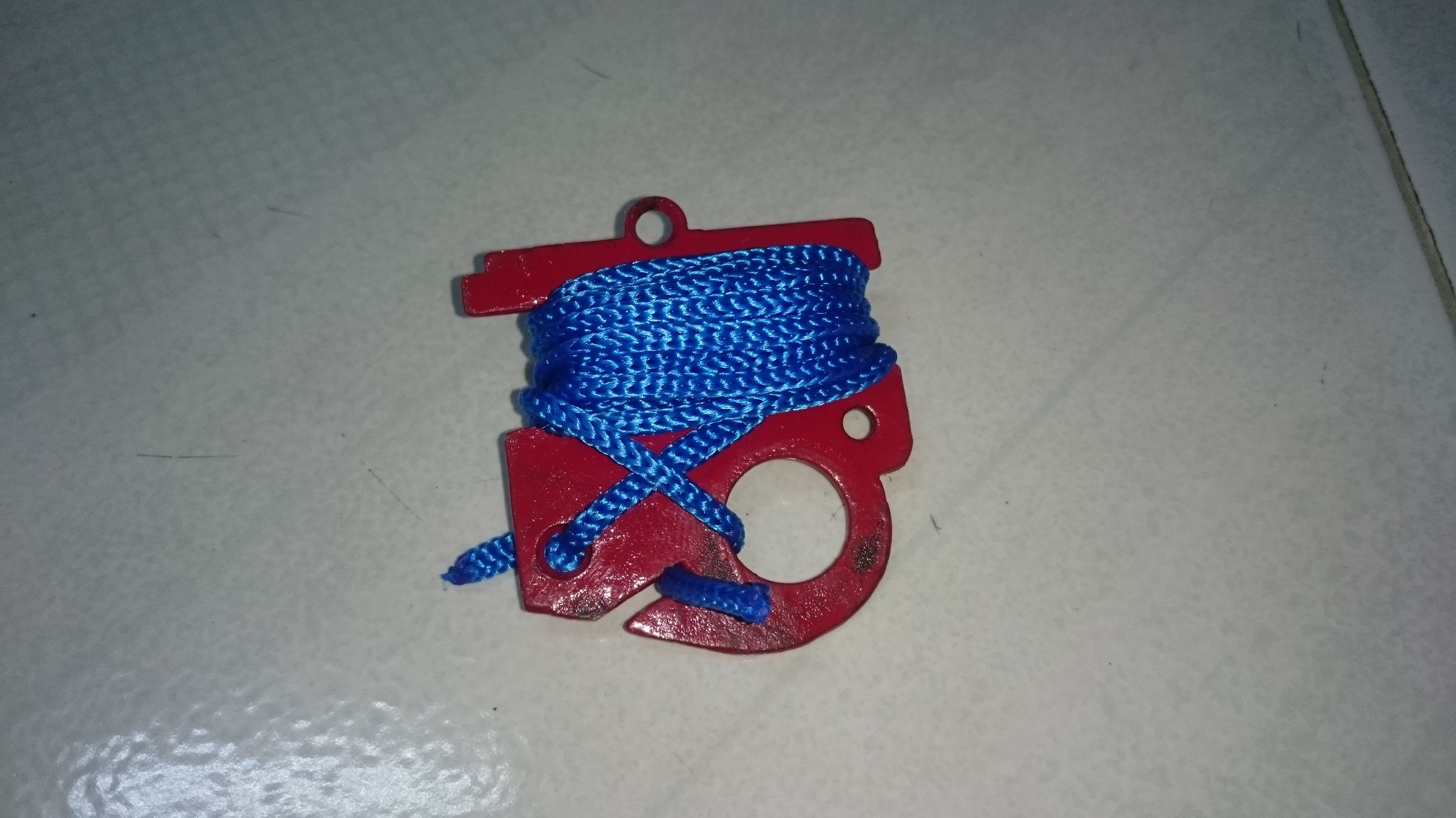

You can keep it in your bag with a bunch of paracord around it.
You can use it to hold your rolled shirt, bag or tent.

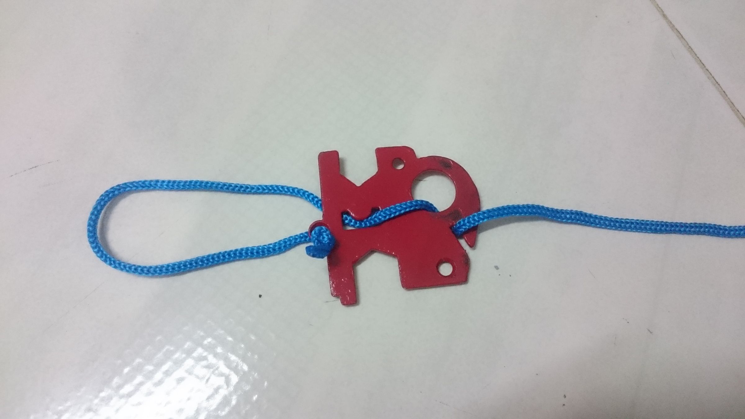

Use it as a pile hanger and you can adjust the height easily.
And this is the first intention of the making, a rope tensioner, which is useful for building a tent. Then you need to make more pendants like this. I still keep two third of the lock cover ;) I can drill more holes if I need.
