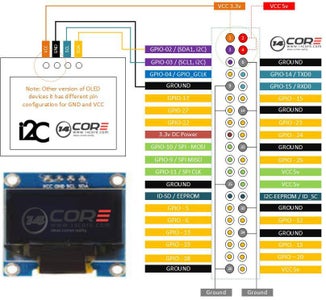

Step 3: The Display
After searching for a while, 0.96inch OLED display appears to be the best and easiest option. This is available everywhere.
Of Course, a smaller one would be better. But I could not find one in our country :(
I bought one of these
This display has I2C interface. Easy deal right? Still, I added an image to show how you gonna wire it up with raspberry pi zero. And... This is the wiring in table -
Display => Pi Zero
VCC => 3.3V
GND => GND
SDA => SDA (GPIO 2)
SCL => SCL (GPIO 3)
⚠️ NOTE: Don't do the mistakes that I did. Some OLED displays has resolution 128x64 but it can have a I2C address of 0x3C not 0x3D which is usual.

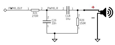

Step 4: The Speaker
Here comes a tricky part man!
Pi Zero doesn't contain a Audio Jack and by default has no audio output other than HDMI. But we can't use that in a glass right? So, after researching for a while, I found this: Adding Basic Audio Output to Pi zero
This is what to do in short -
Pi zero can output audio signal from certain PWM pins. If we simply use a low pass filter to cut the high frequency(50MHz), we can hear it!
Firstly, we need to configure the PWM pins:
(From that article) Simply adding the following line to your /boot/config.txt will reconfigure the pins at boot without any external software or services:
dtoverlay=pwm-2chan,pin=18,func=2,pin2=13,func2=4

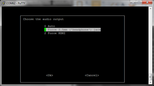

Now, We need to force Pi to output sound on the Audio Jack (we hacked it through PWM pins).
In Raspbian OS, Open console and run
sudo raspi-config
Go to Advanced
Then Audio
Finally Force 3.5mm (Headphone)
👉 If you can't see this option, try restarting your Raspberry Pi. Make sure all the wirings are correct.
I don’t know why, but my speakers started working without any filtering circuit 😐 and didn't work with the filtering circuit after a while. Later, I just used a transistor to amplify it. The sound quality was satisfying.
But, that might not be your case, so you gotta build the simple circuit shown in the image. Also make sure to amplify it after filtering.
(Last 3 image credit: Adafruit)
⚠️ NOTE: I used mono speaker. If you do so, you need to use this command in boot config file:
dtoverlay=pwm,pin=13,func=4

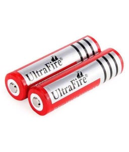

Step 7: The Power
Sadly, Raspberry Pi zero requires much power. Around 2000maH and 5V. Because of Wi-Fi, Bluetooth usage and OS running all the time, the power usage is high as well.

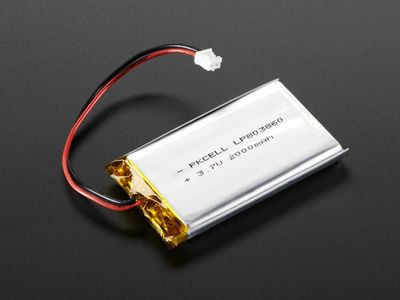

I used a heavy 4000maH 3.7V Li-on battery with a Power Bank circuit that ensures correct voltage as well as provides a charging system! But, this battery is so heavy, it added a lot of weight to my glasses.
The first image shows the exact model I used(collected from internet). Last image shows my setup.
A better option for you will be using some light weight Lipo battery. Like the second image. Check out that battery here

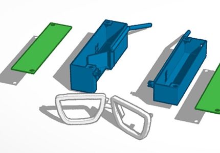

I used two boxes to arrange all the parts on each side of glasses. I kept the Battery, Speaker and Power Button on left, and everything else on right side. You can make the body using cardboards or if you can 3D print a model that would be a lot better!
Step 9: Finishing Task
Yes, it's true.
We are Done!
Beautifying the product is your duty. Maybe, put some color/designs, use fancy glasses instead of simple sheets as glasses. You can make it look like the way you want. It may not be a super cool looking Smart Glass, but this is a good start I think! After all, it was less than 50$ deal 😌. And if you are a hobbyist, it's possible that you already had 90% of the components needed.
The image you can see is a 3D model I created(I am not a pro at this). Check my model: https://www.tinkercad.com/things/l1MXpnD8rrG
