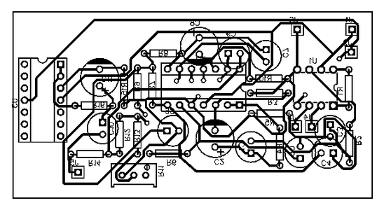

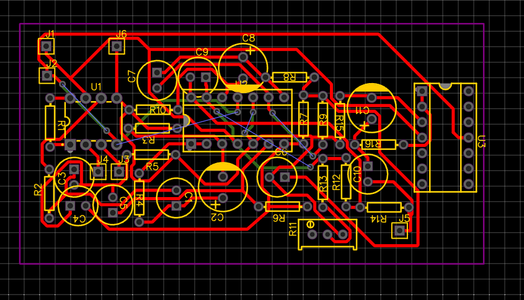

Here's the circuit of the most important part - electroencephalography. I'll explain what's going on here.
We need alpha brainwaves, which have frequency from 8 to 13 Hz. I also made it possible to read beta brainwaves (12-30 Hz), since my EEG filters out the noise which is not between 7 and 31 Hz. Firstly, the signal is amplified 89 times. Then it goes to 60 Hz notch filter, which filters out the biggest noise due to power lines interference. The next one is 7Hz high pass filter. It filters out the noise made by skin. Then comes 31 low pass filter. It just gets rid of anything above our frequency range. Then there's 1 Hz high pass fiter just for extra attenuation of unwanted noise and resistor in parallel with capasitor, which provide extra filtering (~160 Hz low pass filter). Then comes another amplification, but this time with variable resistor. It gives 83-455 gain. The last filter is another 60 Hz notch filter to filter out the noise which is left.

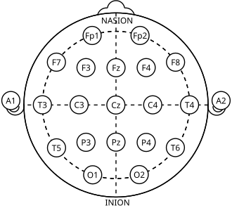

Now about electrode placement. You have 3 electrodes (+, -, and GND). GND electrode is needed to be placed at A1 spot, which is at earlobe. Electrodes + and - should be placed at Fp2 and O2 areas (there shouldn't be any difference between placing + electrode at Fp2 and - O2 or otherwise).
