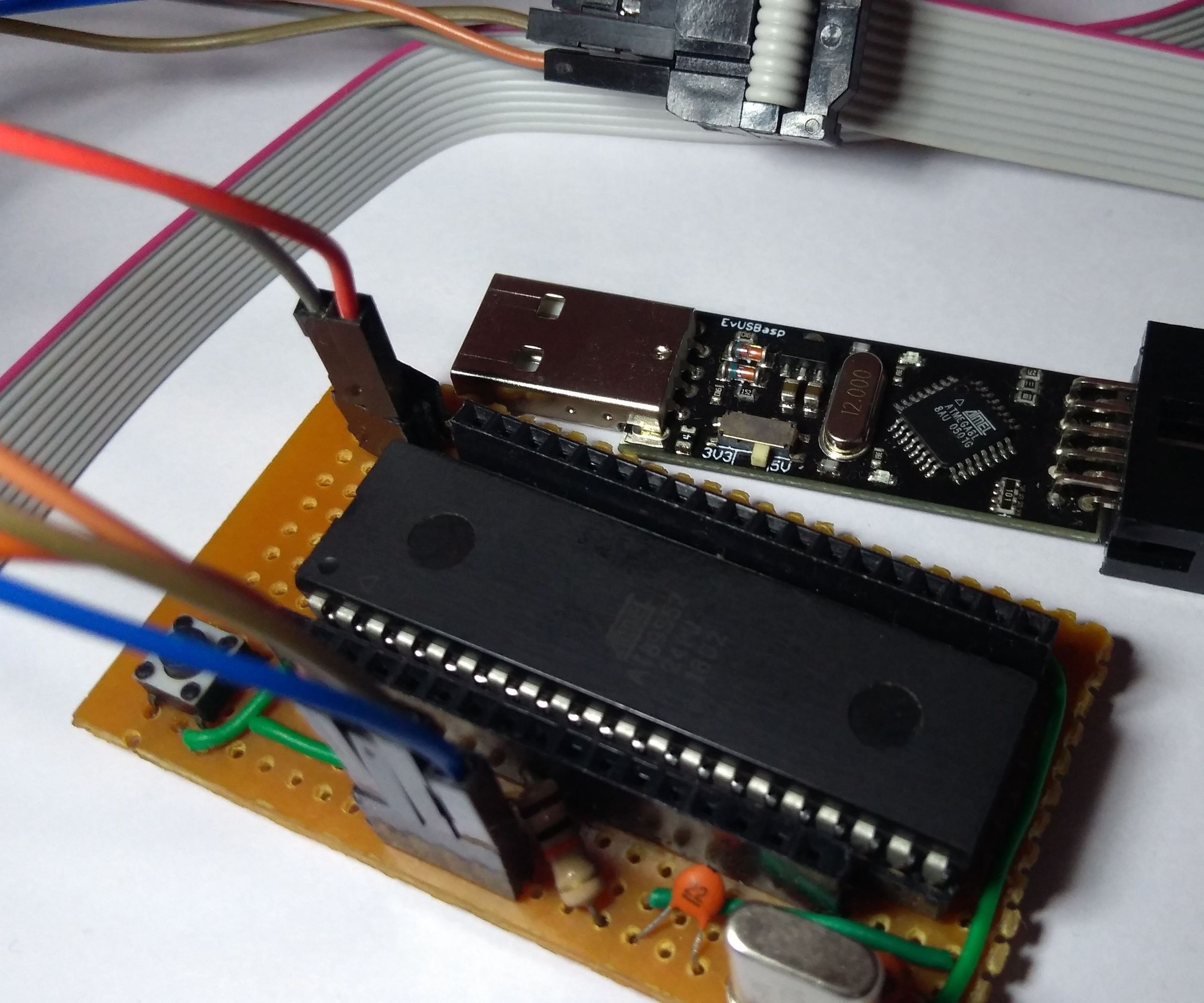

Step 3: Arduino Code
Here i'm using a Arduino mega 2560, you can use any other micro controller as long as it has enough I/O pins.
As mentioned we need 8 data pins, 8 address pins(for 256 Bytes), WE so totally 17 digital pins.
I'll make another Instructable on EEPROM burner using multiplexing concept which reduces number of I/O pins significantly. anyways lets get into the code
1. declaring the pins
int a_pin[] = {22,24,26,28,30,32,34,36,38,40};
int d_pin[] = {5,6,7,8,9,10,11,12};
const byte WE = 3;

Step 4: Testing the Contents
once programming the contents, just make OE(active low) low so that EEPROM outputs stored contents and start giving address values starting from 0x0 to 0xFF and check the contents visually or any other way.
This can be done by just removing the data pins from arduino and let the arduino start sending address values, this should verify the contents you just programmed.
