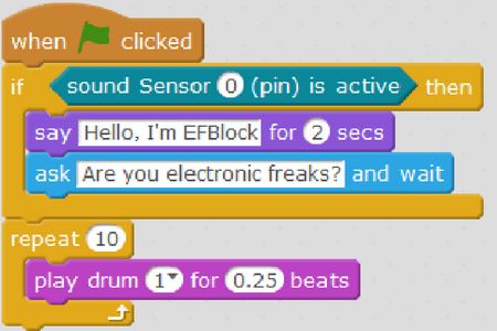

The robot module is corresponding to our peripheral sensor, connect the sensor to the corresponding interface (IO) if you want to use the corresponding script blocks. Here is one illustration: We have 4 script blocks corresponding to 4 different functions:
This block is the head of your program, which must be used at the top.
This block is used for connecting.
This block represents as a numerical value.
This block is usually used to judge the condition: yes/no. Now let's go for what the text stands for.

The first white circle ()of most building blocks display the interface,which you may be puzzled about:
Interface is the needle on motherboard. We use wire to connect the sensor and fill in the number of corresponding interface in the first circle, then the building blocks can be used. Arduino has two interfaces: Analog and Digital, which are abbreviated as "A" and "D" on the board.So check the letter "A"( A_ for analog and _ for digital) before you connect the sensor(e.g. A0/0).
Analog :
Digital:
Such as
With "A" ahead and "0" in the circle, we should connect the button to A0 side of the board. (The color of wire & interface must be matched .)
