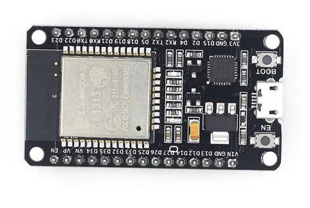

3. ESP32 development board * 1

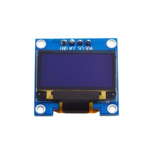

4. 0.96" OLED display * 1

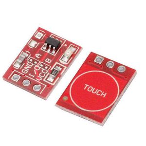

5. TTP223 touch sensors * 3

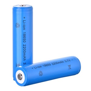

6. 18650 Li-ion cells * 2

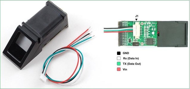

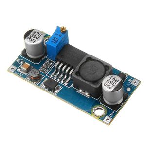

9. Fingerprint sensor * 1

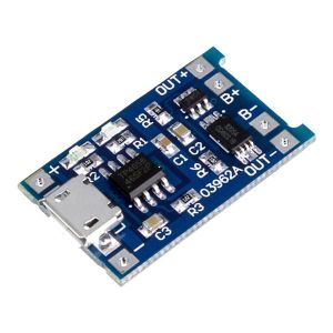

10. 18650 li-ion cell holder * 1

  4. ADAFRUIT FINGERPRINT LIBRARY
