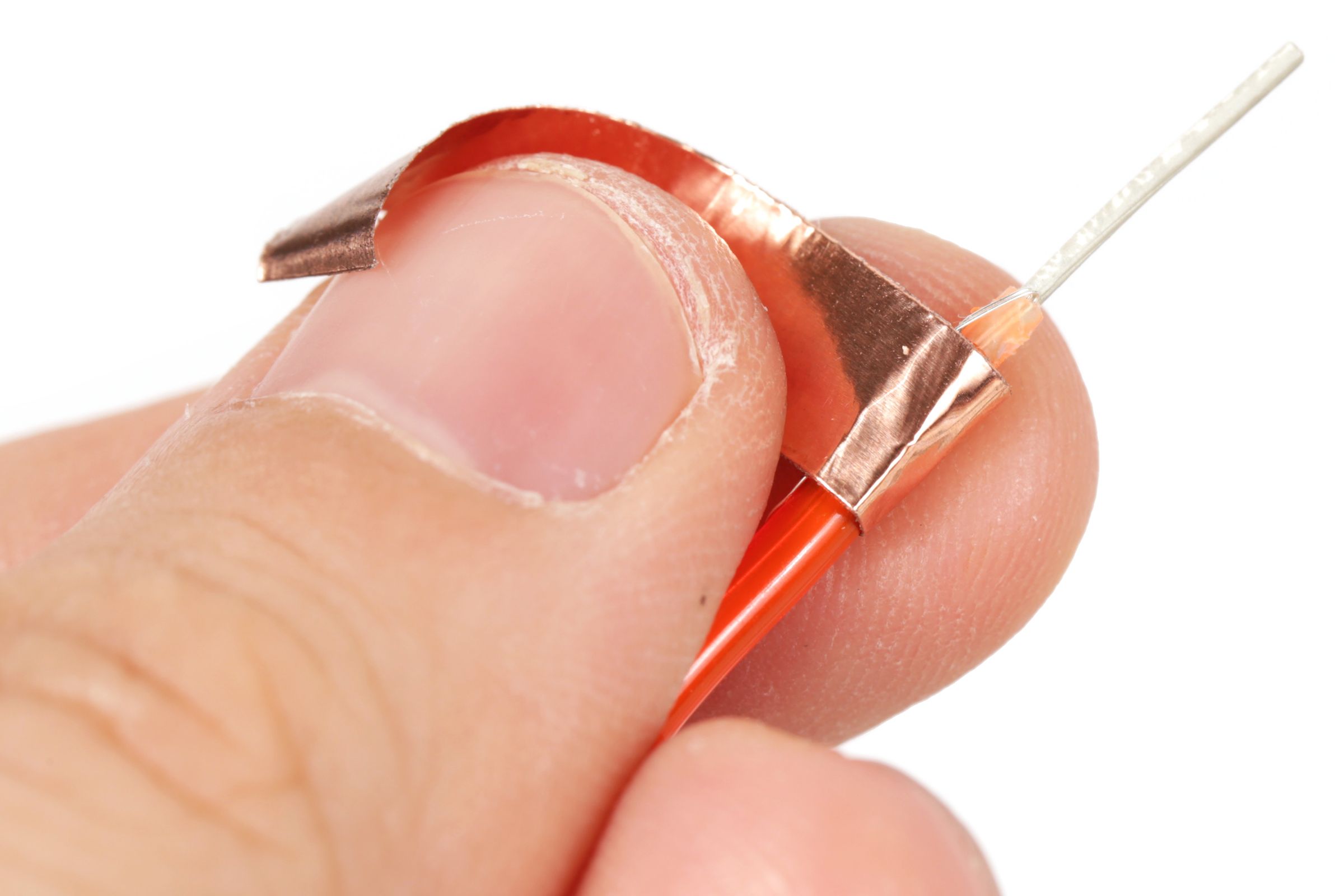

The next step is to carefully strip the color jacket off of one end of the EL wire. The goal is to expose the two outer wires and the phosphor coated center wire. This step may take some practice as the outer wires are very delicate and break easily. It is important to keep both wires intact.
Wrap a piece of long thin piece of copper tape once around the outer jacket of the EL wire. Fold the two outer wires over onto the copper tape and quickly and carefully solder them into place. Once they are soldered, wrap the remainder of the copper tape around this connection to protect it.
Strip the phosphor coating off of an inch worth of the inner copper core in order to be able to solder to it.

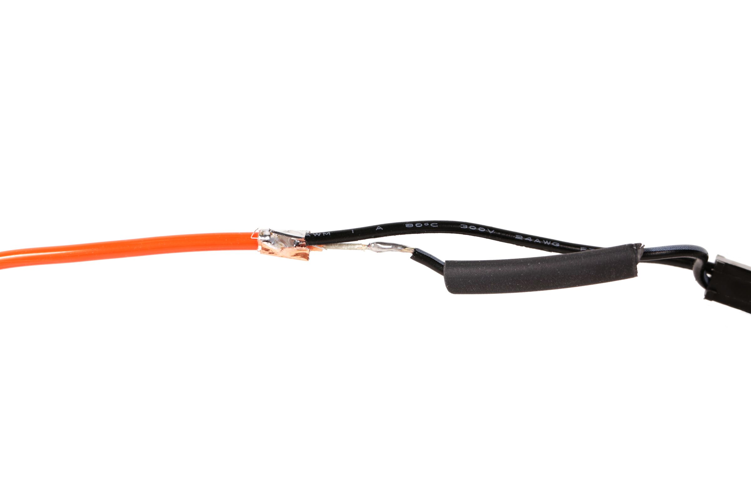

While you could solder any two wires onto the end of the EL wire, it is best to acquire a 2-pin JST female plug. One of the wires will be soldered to the copper tape, and one wire will be soldered to the inner core. It does not particularly matter which wire is which, since it is AC current.
Slide a piece of shrink tube onto the wire that will get soldered to the center core, and then solder the wire in place. Solder the other wire to the copper tape.

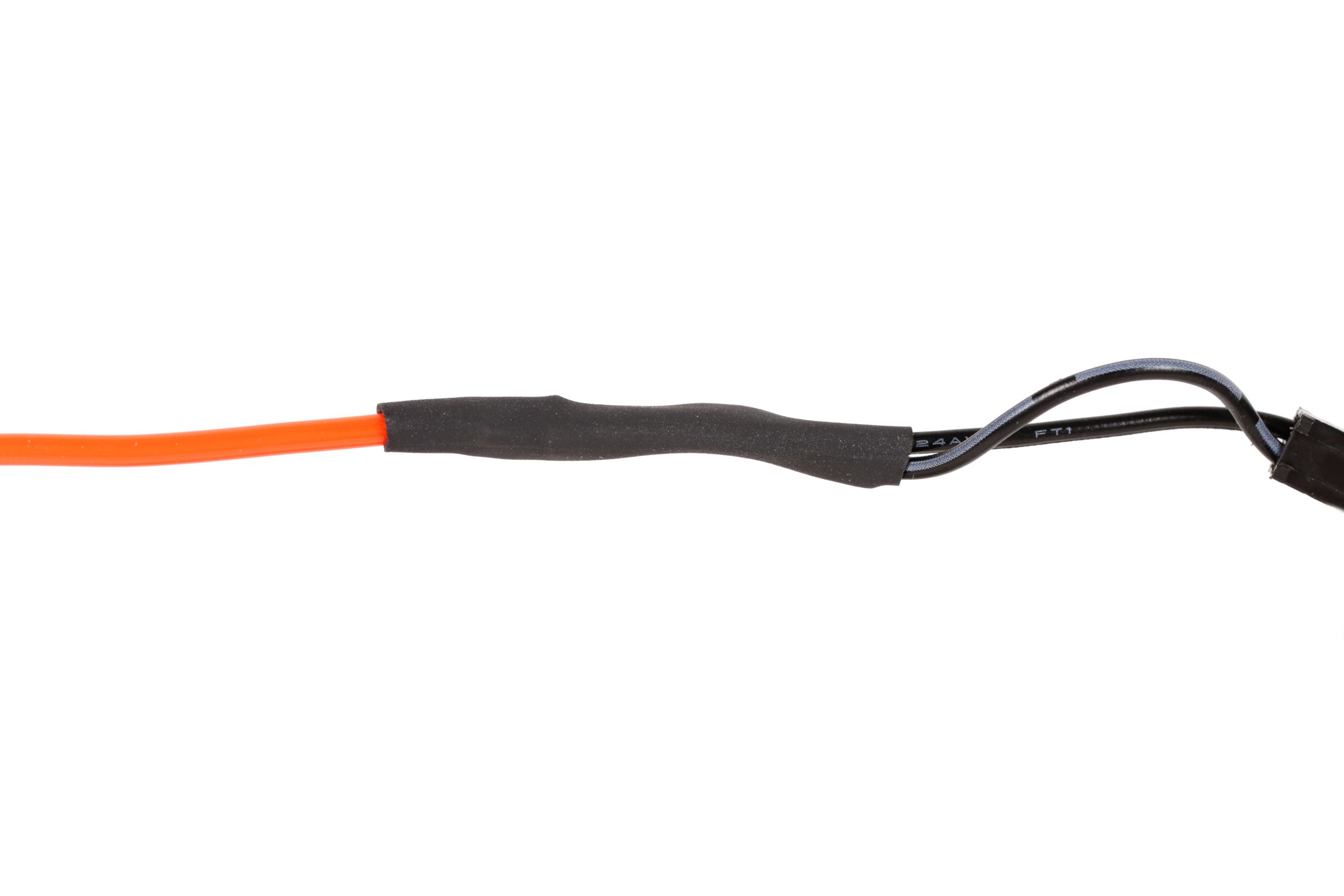

Slide the small piece of shrink tube over the center copper core and shrink it into place. Slide a larger piece of shrink tube over all of the connections and then shrink it into place.
When it's done, connect it to the inverter and turn it on to test that it is working. It should glow.
