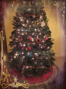

This is a fun and festive project. EL wire adds a festive touch to my christmas tree. Note the blue-ish wire is actually very green. (My camera must not be in the holiday spirit.)

At this point, the wires are ready to go on the tree. You can either spiral them up the tree, or you can do what I did which was to cut hoops. Cutting into the wire is not for those low on patience; it can take some time and several tries to solder the tiny delicate corona wires. Here is a short tutorial on how.
