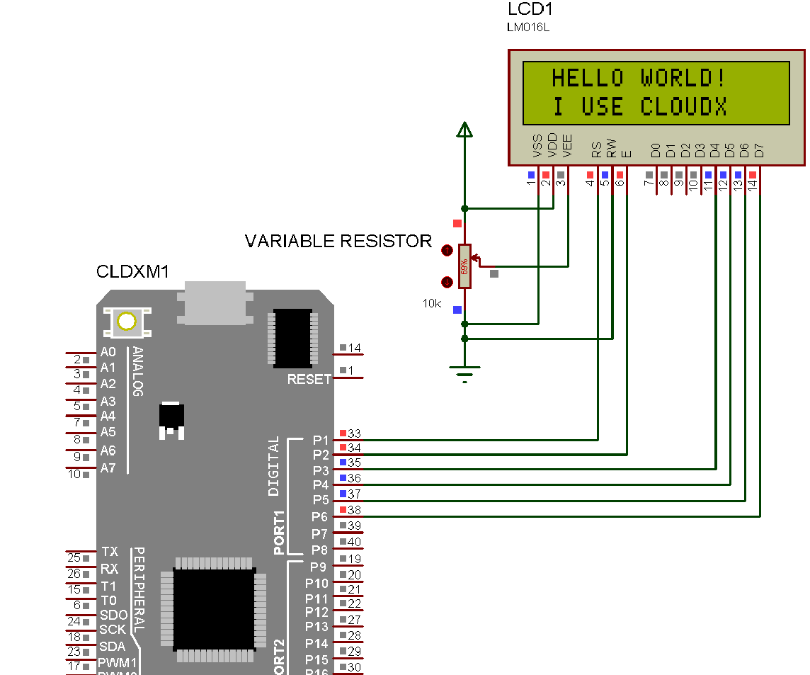

Step 3: Interfacing the LEDs With CloudX M633
The whole circuit is made up of two sections: the microcontroller and the LED sections respectively. The LEDs are organized in two sets with each −(comprising 7 LEDs), representing the normal faces of a dice; and are connected to pin P1 through to pin P14 of the MCU module.
The whole operation revolves round the microcontroller module as the heartbeat of the entire project. It (MCU) can be powered on:
  • either via the VIN and the GND points (ie. connecting them up to your external power-supply-unit’s +ve and –ve terminals respectively) on the board;
  • or through your CloudX USB softcard module.
As clearly illustrated in the schematic diagram above, the LEDs are arranged in such a way that when they light up, they indicate the numbers as they would in a real dice. And we are working with two sets of LEDs to represent two separate dice pieces. All of them are connected in the current sinking mode.
The first group of LEDs comprising: D1, D2, D3, D4, D5, D6, and D7; are connected to the MCU’s pins: P1, P2, P3, P4, P5, P6, and P7 respectively via 10Ω resistors. Whereas the other group consisting of: D8, D9, D10, D11, D12, D13, and D14; are connected to the MCU’s pins: P9, P10, P11, P12, P13, P14, and P15 respectively via 10Ω resistors as well.
Then, the push-button switch SW1 −with which we make a random number generation via a switch press, is connected to the MCU’s pin P16 using a pull-up resistor of 10kΩ.
Step 4: ​Principles of Operation
At start up, the LEDs are normally all Off to indicate that the system is ready for a new random number to be generated for display. On switch press, a random number ranging between 1 and 6 is so generated and displays via the LEDs; and stay On pending when another switch-press is made again.
