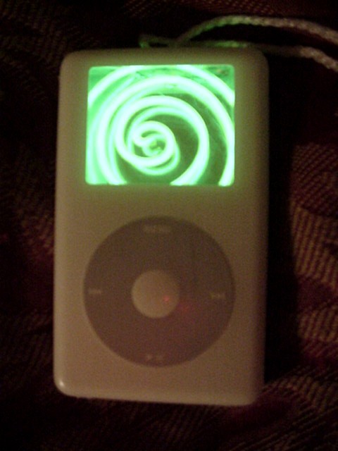

Introduction: ELpod
Broken ipods are depressing... especially if they belong to your sweetie. It sits there, silently staring back at you as if to say "You know, the new models are so much better anyway...". Reap your revenge by turning it into a cool piece of glowing raver bait with cheap and bright electroluminescent wire (el wire) for less than $10 including battery. When she opens it on Valentines day, she'll forget all about wanting a new one... ya' think?

Step 5: Install El Wire
Take your length of el wire and bend it to and interesting shape that looks interesting from the window and reflects nicely from the inside of the back cover. Referring to the tutorial in step #5, strip and solder it to the two leads coming out of the inverter. Cover your connection with heat shrink tubing or electrical tape. Slip your el wire figure in place and secure it in an area that is outside the view window when you test-replace the cover.

Step 10: Fin
Your friends will be green with envy-- or whatever color el wire you bought. Painting by Killbuck.
