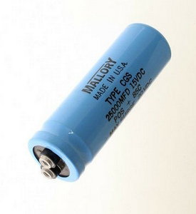

-n°1 set of electrolytic capacitors with minimum voltage of 15 Vdc, to be connected in parallel for a total capacity (sum of the capacities of single capacitors) of 100 milliFarad (or 100000 microFarad; see also the example in the middle right picture);

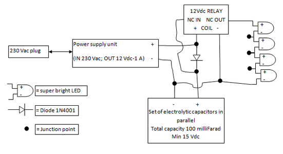

Step 1: Circuit
In the scheme You will find described the connections required between each component previously listed in the Supplies section. Hope it is enough simple also for those who lack the base knowledge of electric circuits. However, I assume that those interested in this circuit are aware of the risks of electric circuits, and can handle also the work required by this circuit without damaging neither them nor their houses.

After having completed and checked the last soldering, the circuit can be tested by putting the plug into a socket of the house. The capacitors will be charged, but the LEDs will not be on because the normally close contact (NC) of the relays will be open (the coil will be fed by the power supply unit).
After removing the plug the coil of the relays will not be fed anymore, and the NC contact will close, allowing the capacitors to feed the LEDs.
