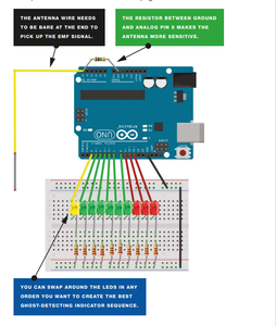

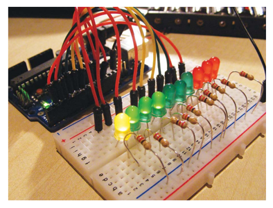

Step 1: CONSTRUCTION:
1. Place the LEDs into the breadboard with the legs on either side of the center divide. I started with a yellow LED, then used six green and three red LEDs to create a scale from left to right. You can use any color LEDs and position them in the sequence you prefer.
2. Connect one leg of a 220-ohm resistor to each negative LED leg, and insert the other resistor leg in the GND rail of the breadboard. Connect each positive LED leg to digital pins 2 through 11 in turn. LEDs arduino Positive legs Pins 2–11 Negative legs GND via 220-ohm resistors.
3.Take the 20-centimeter length of single-core wire and use a wire stripper to strip about 1 centimeter of the insulation from one end. Attach this end to Arduino pin A5. Strip about 7 centimeters from the other end—this open, bare wire end is your antenna and will pick up the electromagnetic signal.
4. Connect one leg of the 1M-ohm resistor directly to GND on the Arduino and the other leg to Arduino pin A5; this will increase the sensitivity of your device.
5. Check that your setup matches that of Figure, and then upload the code in “The Sketch”.
Step 2: WORKING:
I might be stretching things a bit by calling this project a EMF detector. This project actually detects electromagnetic fields.
In this project, you’ll set up a EMF-detecting antenna and LED bar graph system to tell whether there is a high level of electro magnetic activity in the vicinity. A length of bare wire acts as an antenna to pick up an electromagnetic field within a radius of two meters. Depending on the strength of the signal, the LEDs will light in sequence: the stronger the signal, the more LEDs will light. Power up the Arduino, and point your detector into a room to pick up any unusual presences. Be aware that electrical appliances such as televisions will cause the detector to dance around because of the signal they emit.
The bare wire picks up the signal from electromagnetic fields in the atmosphere and sends a value between 0 and 1023 to the Arduino. The sketch evaluates the reading from the analog pin to determine how many LEDs are switched on or off in sequence to indicate the strength of the electromagnetic signal. For example, 1023 would be the highest value, so all LEDs would be lit; a reading of 550 would light five LEDs. The sketch loops to continuously read the analog input, and the LED lights constantly move to show the reading. If you find that the EMF readings set off your LED sequence to the maximum level every time, reduce the sense limit value to compensate. The sketch takes an average of 25 number readings each time it loops through, and uses the average from those readings to mitigate big fluctuations that may cause the LEDs to light up too quickly.
