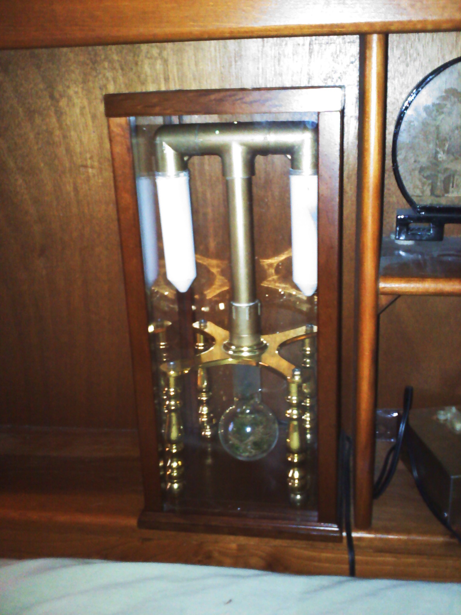

Step 4: Finished Board
Step 5: Finished Product
I will most likely add a decal to the PVC pipe.
