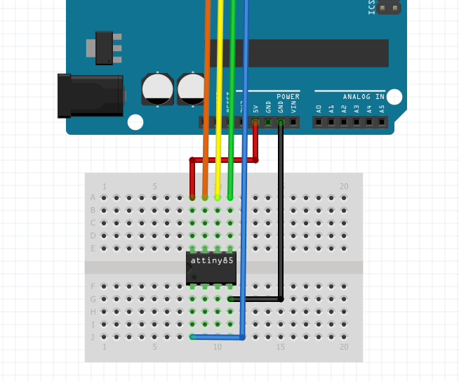

You will need
1 EMF Detector shield ( or breadboard)
look for: ATtiny 85 programmer shield for Arduino UNO
4x 100R or 120 Ohm resistors to limit the current to the LEDs if 3 volt CR 2032 button cell battery is used
OR 4x 180R to 200R resistor if an LIR 2032 @ 3.6-volt button cell battery is used
4x LED light emitting diodes
4x 1M resistors
1 x 8 pin socket, as you may want to take the IC out to fine tune the settings
1x ATtiny85 chip from a reliable source. I can sell you one or Element 14
1x signal diode 1N4148
not necessary, but I always include a 250 mAH resettable fuse, especially when designing on a breadboard
available on eBay
look for: 72V 250mA 0.25A Resettable Fuse Radial PPTC Polyswitch
http://www.ebay.com.au/itm/10-Pcs-72V-250mA-0-25A-...
1x battery holder for button cell or two 1.5volt AA batteries
1x switch
1x battery LIR 2032 @ 3.6-volts OR CR 2032 @ 3 volts. Note that I use different resistors.OR 2x 1.5 volt AA or AAA
wire for the antenna if you make your own (mine is etched into the circuit board) but also provides a pin to attach other self-made antennas.

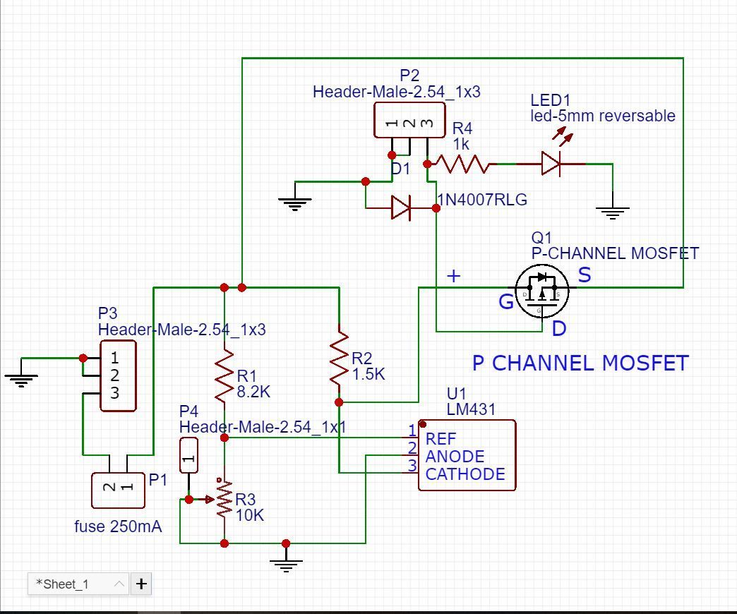

Step 3: My First Prototype With Antenna
On my first prototype, I experimented with an antenna. It is just as good. If you leave the diode off it is more sensitive, but also more unstable.
This version has no current limiting diodes as the voltage is only 3 Volts. But it is better to use them for extended LED life.
http://led.linear1.org/1led.wiz
My calculations are
3 volts source voltage
2.76 forward voltage
2.38 forward current
And the online calculator comes up with 120 Ohms.
So I used the next smaller resistor, having plenty of the 100 Ohm in stock.
For testing the diode voltage and current I used my Digitech QT2216 Component tester I had purchased at Jaycar for around $45.
But every time there is something good on the market someone buys it outright and sells it for a much higher price or it was a copy of the Comtech.
Now you find them too expensive. Search: GA72640 COMTECH
