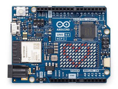

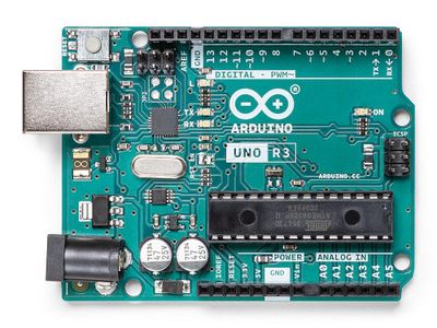

Step 2: Arduino UNO R3 Vs R4 Minima and R4 WiFi
The Arduino UNO wikipedia page has a very good summary of the differences. Two images of genuine boards are shown above borrowed from the Arduino site. Here are some highlights.
- UNO header remains the same but the R4 has handy labels on the inside and outside.
- R3 has "old" USB-B connector, R4 has USB-C.
- R4 has a 48MHz 32bit RA4M1 (ARM) microcontroller with FPU, R3 has 16MHz 8bit ATmega328p CPU.
- R4 has 256KB flash storage, 32K static memory, 8K EEPROM vs R3 32KB/2KB/1KB.
- R4 WiFi has 12x8 charlieplexed red LED display, an additional Espressif ESP32-S3 coprocessor for WiFi and one Quiic connector.
- R4 has a 12bit DAC for true analogue output. This isn't particularly relevant to this article but it's a useful addition for other projects.
