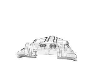

Design TRES (GREEN):
This model tackled the largest problem of DOS, printing the piece in a normal commercial 3-D printer. Tackling this problem allowed the prosthetic to be much more accessible to individuals using household printers, as well as offered the important advantage of strengthening the structure.
Henceforth we split up the large piece into two pieces: ALPHA and BETA
ALPHA is the square portion where the prosthesis makes direct contact with the user’s hand.
BETA is the hydrodynamically designed portion which first breaks the water during the free-style stroke.
These two portions fit together by a pin, sized to be able to work much like the pins in the Raptor Reloaded.
In fact, we made sure that the pins from the Raptor Hand and Empower are interchangeable!
In order to better optimize the hydrodynamics of the design, the bottom portion of BETA was redesigned.
A Christmas tree design was added to channel water away from the user’s hand. This allows for fewer forces from the water to be placed directly on the hand of the user.
The problem we found was that there was nothing maintaining Beta’s position relative to the gauntlet. When it was being used, BETA would flop around the pin, and wouldn’t stay in the swimming position.

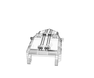

Design Final:
This model addresses all other problems by having the same features as TRES by including tensioner wires. This included small holes near the tip of BETA, small tensioner holders on ALPHA and BETA and small semi-circular stoppers.
The small holes near the tip of BETA were designed to secure the new tensioning wires.
The tensioner holders on ALPHA and BETA were designed to maintain tensioner position through the turbulent movements of swimming
Small semi-circular components were added to make sure that BETA didn’t flop under the strain of the tensioner wires.

Step 8: Wiring
To begin with, cut a length of stretchy wire the length of BETA.
Then run this through the holes near the tip of BETA, and make a slipknot
Run the wire through the protrusion on the top of both BETA and ALPHA, and secure them to the tensioning pins in Raptor Reloaded’s gauntlet
It is very important that they are as taught as possible.
Again you can use a slipknot to secure them to the gauntlet’s pins
Note: It is not necessary to run stretchy wires through all of the holes, and to attach them.
The team noted that the prosthetic works best with 2 or 3 pin connection, depending on how taught your connections are.
