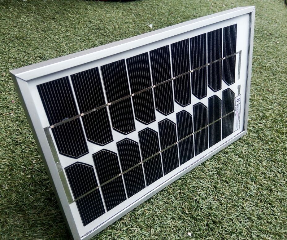

STEP 1
Take the solar panel and remove its aluminium molding from its sides. Remove the black cabinet which is fixed with the solar panel at the back side of the plate,you can see the image of the panel after removing the cabinet. Take the wooden ply and make a big hole for the output of the solar panel as you can have idea from image.
