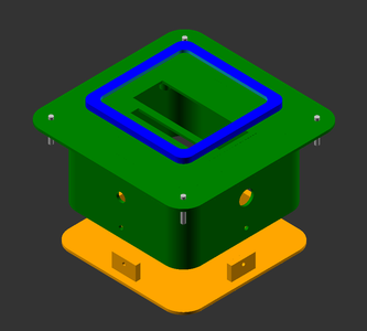

Step 1: Print Parts
  1. Download the printable parts from the King of the Blaster printables website.
  2. Print all parts in PETG filament for outdoor durability.
  3. No supports are needed.

Step 5: Mount LED to Case
  1. Put the LED in place as seen in the photo.
  2. Remove it and note where the upper edge is.
  3. Add Superglue on the upper edge of the LED.
  4. Mount the LED display as pictured to the top case.
  5. Wait for glue to dry.
Note: These photos are from v1 of the top case, but the procedure is the same.

Step 9: Attach Screen Cover
  1. Place one piece of acrylic panel over the screen and LED.
  2. Put super glue in the groves around the screen.
  3. Attach the black frame on top of the acrylic panel, lining up with the groves.
  4. Wait for glue to dry.
