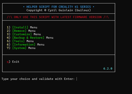

To install moonraker, mainsail/fluidd and other things, we use the Creality helper script from Guilouz
First, clone the git repository via
git clone https://github.com/Guilouz/Creality-Helper-Script.git /usr/data/helper-script
and then run the helper script with
sh /usr/data/helper-script/helper.sh
inside the script access the [Install] menu and install
  1. moonraker and nginx
  2. fluidd or mainsail (depending on your preference)
  3. entware
  4. other things you may find useful, but are not strictly needed
!!! You must not install the "Save Z-Offset" feature. It will make HappyHare not work correctly. If you have installed it already, uninstall it via the [Uninstall] menu in the helper script !!!
This would be a good moment to check if installation has been successful. Go to your browser and enter <printer_ip>:4408 for fluidd or <printer_ip>:4409 for mainsail and see if you can connect to your printer.
If everything works as intended, exit the script.

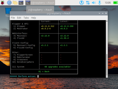

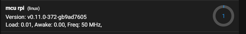

Because K1 Series ships with outdated Klipper version, you also have to flash the ERCF board with that Klipper version, otherwise the printer can't communicate with the ERCF. This is only tested for firmware version 1.3.3.29!
Install Klipper with KIAUH script,
cd ~ && git clone https://github.com/dw-0/kiauh.git
execute the script
./kiauh/kiauh.sh
and install Klipper from the Installation menu.
Enter the update menu and check the installed Klipper version, e.g. v 0.12.0-290
Exit the update menu and enter the advanced menu and from there Klipper repository rollback. You are asked how many commits you want to reverse. We need the latest v 0.11.0 Klipper so enter your current version number +1, i.e 291
You may exit the menu and confirm in the update menu, that your Klipper is now on v 0.11.0-312 and exit KIAUH. for future Klipper versions > 0.12.0 you might need to iteratively downgrade to v 0.11.0-312. For future firmware versions of your printer, that might upgrade Klipper to a newer version, go to machine tab on mainsail/fluidd and look at the version number of mcu rpi, up to the dash it should match the Klipper version in use, after that it can deviate.

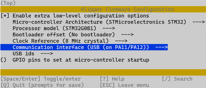

Next, you have to compile the Klipper firmware for your board:
cd ~/klipper
make menuconfig
This will open a menu, where you set the correct parameters for your board. Please see the documentation for your board for the specific parameters. For BTT MMB the settings can be seen in the picture above. Press q when done with the config, confirm and enter
make
