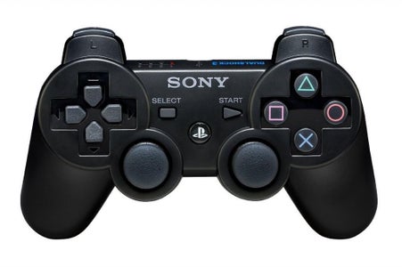

PS3 Wireless Controller Setup
ESP32
You need an ESP32 that supports classic Bluetooth (not BLE). Here’s the one I use: ESP32-WROOM. I learned this because I first tried an ESP32-S3, but it wouldn’t connect to my controller.
ESP32-WROOM
PS3 controler
You’ll need a real PS3 controller. Some knockoffs claim to be PS3 controllers but don’t actually use classic Bluetooth, so they won’t work with the ESP32-WROOM. You can usually find used ones online - including Amazon.
A windows computer or virtual machine
You’ll need Windows for this step. I used Sixaxis Pair Tool (Windows only) to set the MAC address on my PS3 controller. You have to write your ESP32’s factory-set Bluetooth MAC into the controller so it knows who to pair with.

Step 3: PS3 Controller
I pretty much followed this amazing blog step by step.
First download the Ps3Controller.h library from the Arduino library manager.
One thing that was a little different for me was that I had to set my PS3 controller MAC address to my ESP32’s hardcoded Bluetooth MAC address. You can find the ESP32’s MAC using this script:
#include "esp_bt_device.h"
#include "esp_bt_main.h"
#include "esp_gap_bt_api.h"
void setup() {
Serial.begin(115200);
if (!btStart()) {Serial.println("Failed to init");return;}
if (esp_bluedroid_init() != ESP_OK) {Serial.println("Failed to init bluedroid (whatever that is)");return;}
if (esp_bluedroid_enable() != ESP_OK) {Serial.println("Failed to enable");return;}
const uint8_t* mac = esp_bt_dev_get_address();
Serial.printf("esp32 mac: %02X:%02X:%02X:%02X:%02X:%02X\n",
mac[0], mac[1], mac[2], mac[3], mac[4], mac[5]);
void loop() {
delay(20000);
After that, I used six axis pair-tool on a Windows computer. It’s an easy download. Just plug your PS3 controller into the PC via USB, and the tool will recognize it. Then, you can set its MAC address. Type in the exact ESP32 MAC address you got from the script above. Then update it.
Also change the MAC address in the Ps3Controller.h examples in the set up function. Successfully run the PS3 Demo and youre done!
