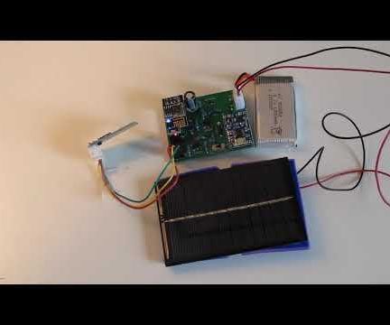

Step 1: ESP-01 Deep Sleep Module
The deep sleep module uses two working voltages. The random 5v+ of the battery pack for the PIR and also a 3.3 volt regulator board for the ESP-01. I also incorporate a diode into the circuit to prevent damaged parts from reverse voltages. This does use a bit of extra power and does drop the battery pack voltage by 0.7 volts. The diode can be left out of the circuit if you are sure you will never reverse the battery pack leads. A switch is also added out of convenience.
This module is a minor update to my original non-deep sleep layout. In the non deep sleep configuration, the PIR is directly connected to RX pin of the ESP-01. I am using the RX pin of the ESP-01 as the input pin for the PIR for a few reasons. GPIO0 did not work because on boot the PIR output PIN would be LOW causing the ESP-01 to enter flash mode. I did not use GPIO2 because then I could not use the built-in LED for visual feed back. The RX and TX pins are often described as extra IO pins but my experience is that RX is an extra INPUT pin and TX is an extra OUTPUT pin.
In deep sleep configuration, the RX connection is not strictly necessary. I am using it only to monitor how long the PIR is triggered by turning the LED on while input is HIGH. As mentioned before, if you clear out the loop function and only use the setup routine then the RX connection is unnecessary.

Please note that in the video the circuit board uses a ESP-01 breadboard adapter instead of the 2 x 4 header. While this adapter is easier to solder the 2 x 4 header works fine and actually fits better.
