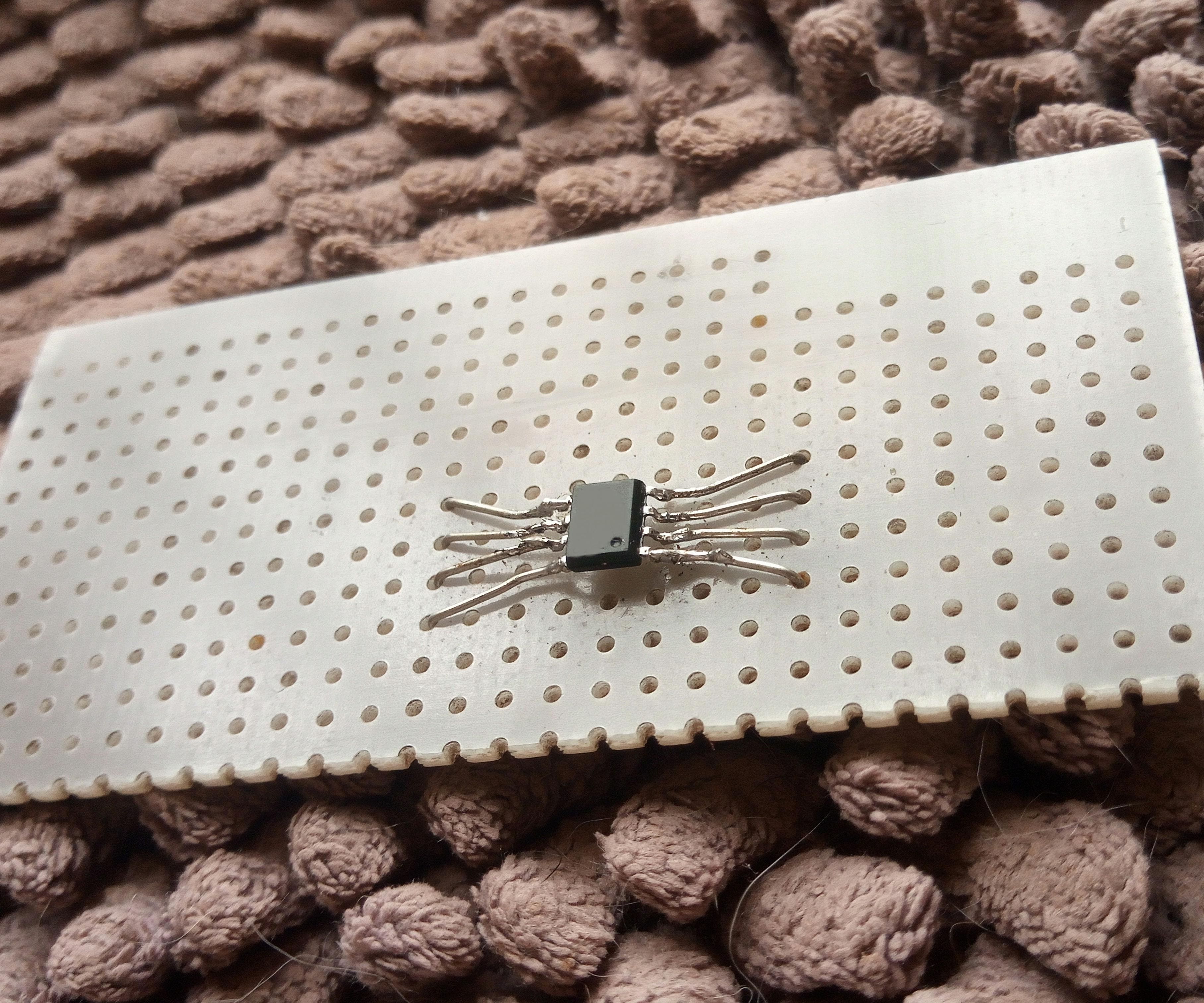

Step 2: Cutting and Preparing the Veroboard / Dot Board
Next, we cut the veroboard to required size minimum (6 x 17 dots) excluding the cutting lines as show in the image. After cutting the piece out use a rasp or sand paper to smooth out the edges.
