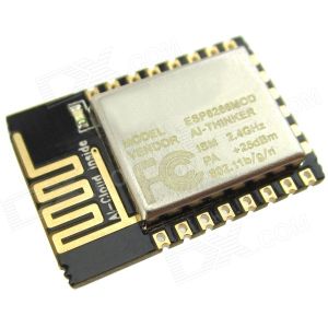

1. ESP - 12e (1) & CP2102 USB to TTL converter (For Programing)

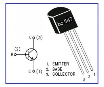

3. BC547 (4)

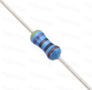

4. 470 Ohm Resistors (8)

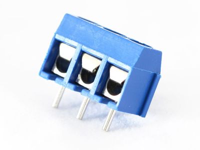

8. 3 pin terminals (4)

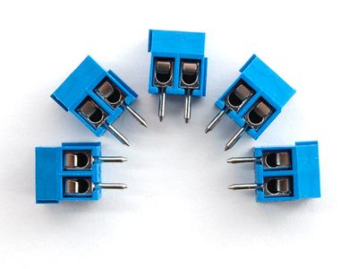

10. 2 pin terminals (1)

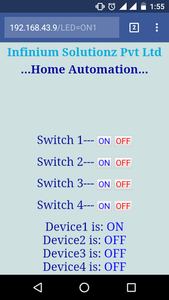

Here are the required PCB design and basic arduino code for controlling relay within a LAN. Before burning the code to ESP 12E, make the changes in the code i.e. change the SSID and Password as per your wifi connection. Also dechange the Stattic IP in the code as per your wifi gateway. Now burn the code on ESP 12E and provide 5V power supply to the board. Now you can go in any web browser in your Laptop/Mobile phone and open the IP address that you have assigned in the programming. The HTML page will Open and you can control relays from there.
