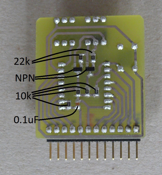

- 2 off BCW32 or other SOT23 format NPN transisitor.
- 4 off 10k 0805
- 2 off 22k 0805
- 0.1uF ceramic 0805

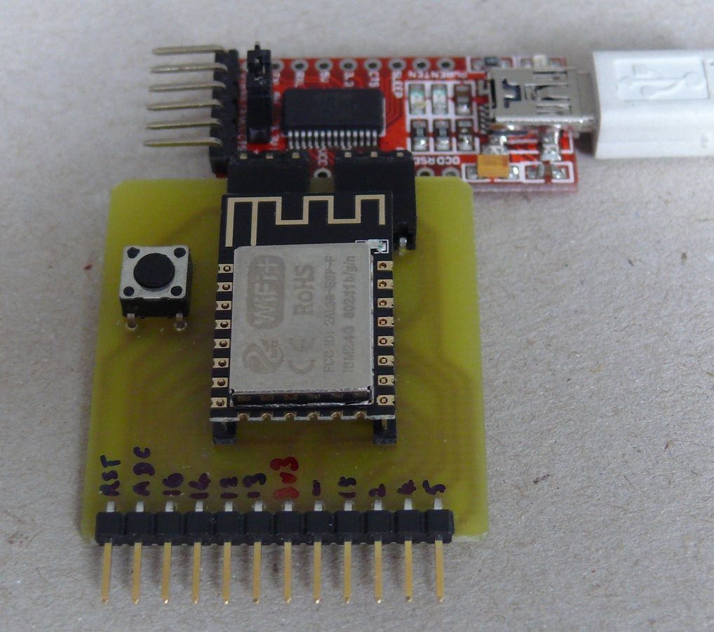

The NodeMCU programming system uses the serial RTS and CTS lines to drive the reset and GPIO0 pins to set the programming mode. A couple of NPN transistors are used. When DTR is high and RTS low the Reset pin is pulled low. When DTR is low and RTS high GPIO0 is pulled low. The programming software drives the DTR and RTS pins as required to put the ESP12 in to flash mode.
Circuit diagram:
A FTDI USB to serial converter is used as it has the lines required on one side. Hence one just has to add some pin headers.
When programming ESP12 modules on this breakout board one either selects NodeMCU V1.0 as the board in the Arduino IDE or if using Generic ESP8266 then set Reset Method (in Tools) to nodemcu. You can then click download whenever you want to load your sketch. The board needs 3.3 power applied to the 3.3v and GND pins.

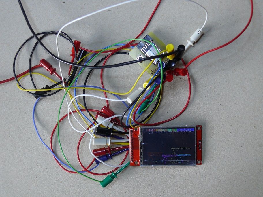

I built this to help develop my TicTac Super Wifi Analyser, but knowing that it will become my favourite tool for developing and testing ESP8266 systems using the ESP12 boards.

I solder components in height order. I place a SMD component, apply solder paste to one pin and solder this. I then do the same for the rest of the SMD components. Then I apply paste to all the unsoldered pins and then go around and solder these.
I did not push the 2mm pin-strip all the way in - but just enough so the pins protruded by around 1mm. When done the plastic bar can be pushed down to the board level. This saves having to trim them and allows the ESP12 aerial to be a mm further away from the FTDI connector.

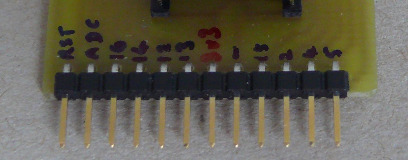

Lastly solder the 12 way right angle 0.1" pin-strip and label as below:

Select board: Generic ESP8266 Module or NodeMCU v1.0 (ESP-12E Module). The former gives more options. See below for the rest of the settings. The Port number is likely to be different. Click PORT to see which one appears when the FTDI module is connected.
Now power the board with 3.3v to the 3.3v pin and connect GND. Plug in the FTDI USB to Serial converter. Now you can program the board just by clicking the download button. After you have done this a few times you will see the value of this little board.
I used this to develop my TicTac Super Wifi Analyser
