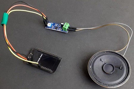

Vcc and ground of audio amplifier is connected to Vin and Gnd of esp 32 respectively and IN pin is connected to Gpio 25 which is DAC pin of esp 32. The two points of the speaker is connected to speaker terminal of audio amplifier.
After connection our system looks as below
Audio Player with esp 32 own circuit diagram
